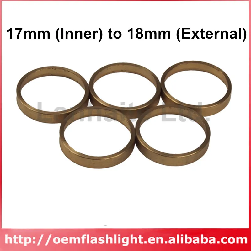

After your find a driver you want, and since most of them will be 17mm, you can try to use one of these rings (confirm the diameter to see if it is suitable) to adapt the driver to the pill and make better contact.
