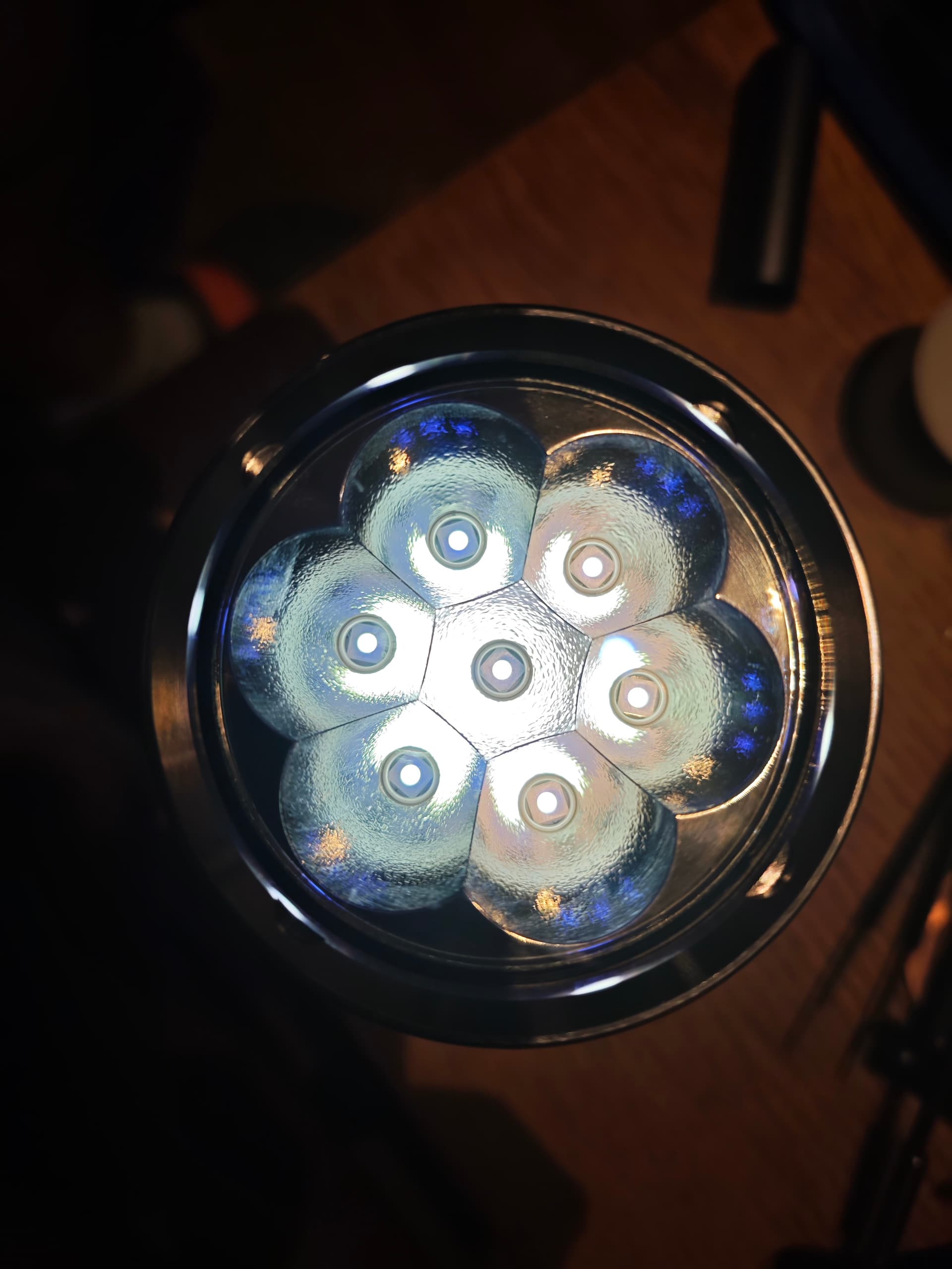

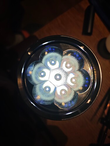

Are these all the same CCT or are the right 3 warmer?
Would be awesome if you could take some output and throw measurements!
All 7 of them are pretty much BA bin, very but pleasantly white 6500K SFT42R. Just realized that, in the moonlight picture of mine, right three of them look warmer…
