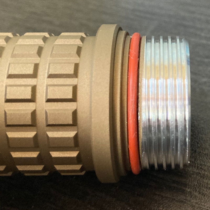

No pic in the first post just because I couldn’t see any difference between its state and just unscrewing it a half inch, but here’s what the threads look like now.
I got a T9R at the same time and the threads feel much smoother. For comparison:

I have a NOV-MU from FireFlies that shares the same tube. The anodized threads are okay, but the tail square-cut threads are pretty rough. The tail threads were not on par with other premium priced flashlights. The threads were bad enough that applying the included lube did not help much. The threads had rough edges and I could see rough machining marks even with my bare eyes. I see similar machining marks (stripe marks) on the top photo, but not on the bottom photo. So I guess not all FF lights have this problem, but the problem is not uncommon enough to be discussed several times in this forum.
I lightly sanded the rough edges with high-grit sand paper wrapped around a wooden chopstick and knocked out some large burrs that were not properly removed. After I spent good amount of my time sanding away rough edges, my tail threads are now smooth. But I think I should not have to worry about these problems in premium-price flashlights. Machining in other parts of the flashlight seemed okay to me, so I think FF can resolve the rough tail threads issue pretty easily if they pay a little more attention.
