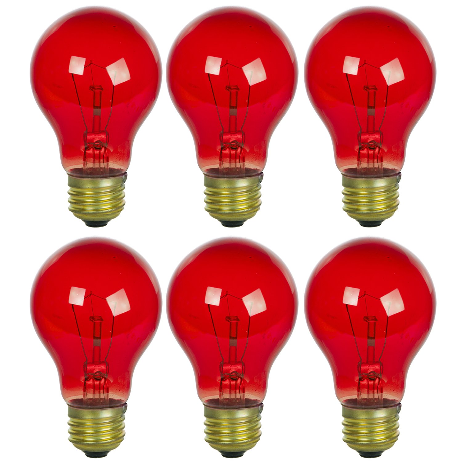

I’ve previously used 25W red incandescent bulbs for winding down at night. My local store stopped carrying them. I tried the LED equivalent and it was terrible. Instead of a soft, deep red; it was more of an orange. It appears to be a cool white LED inside a red plastic dome. I know there are red emitters. There is an interesting discussion of deep red in the flashlight section. So where can I find that in a standard-sized bulb?

Simpler would be to just get a 25W appliance bulb and stick a red filter-cup atop it to filter the light just like the colored glass envelope. Zero “pwm” and the same broadband red light as before.
