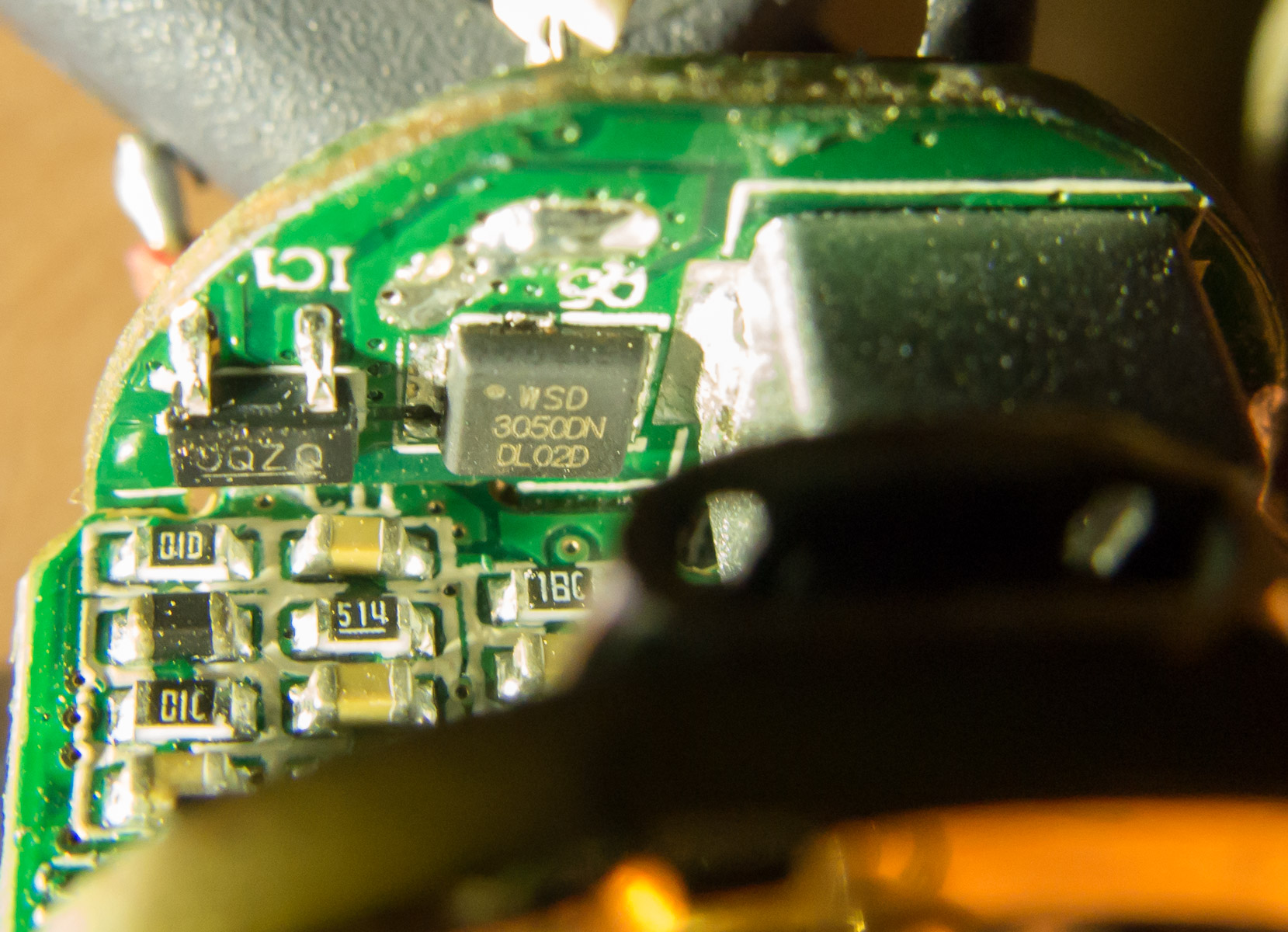

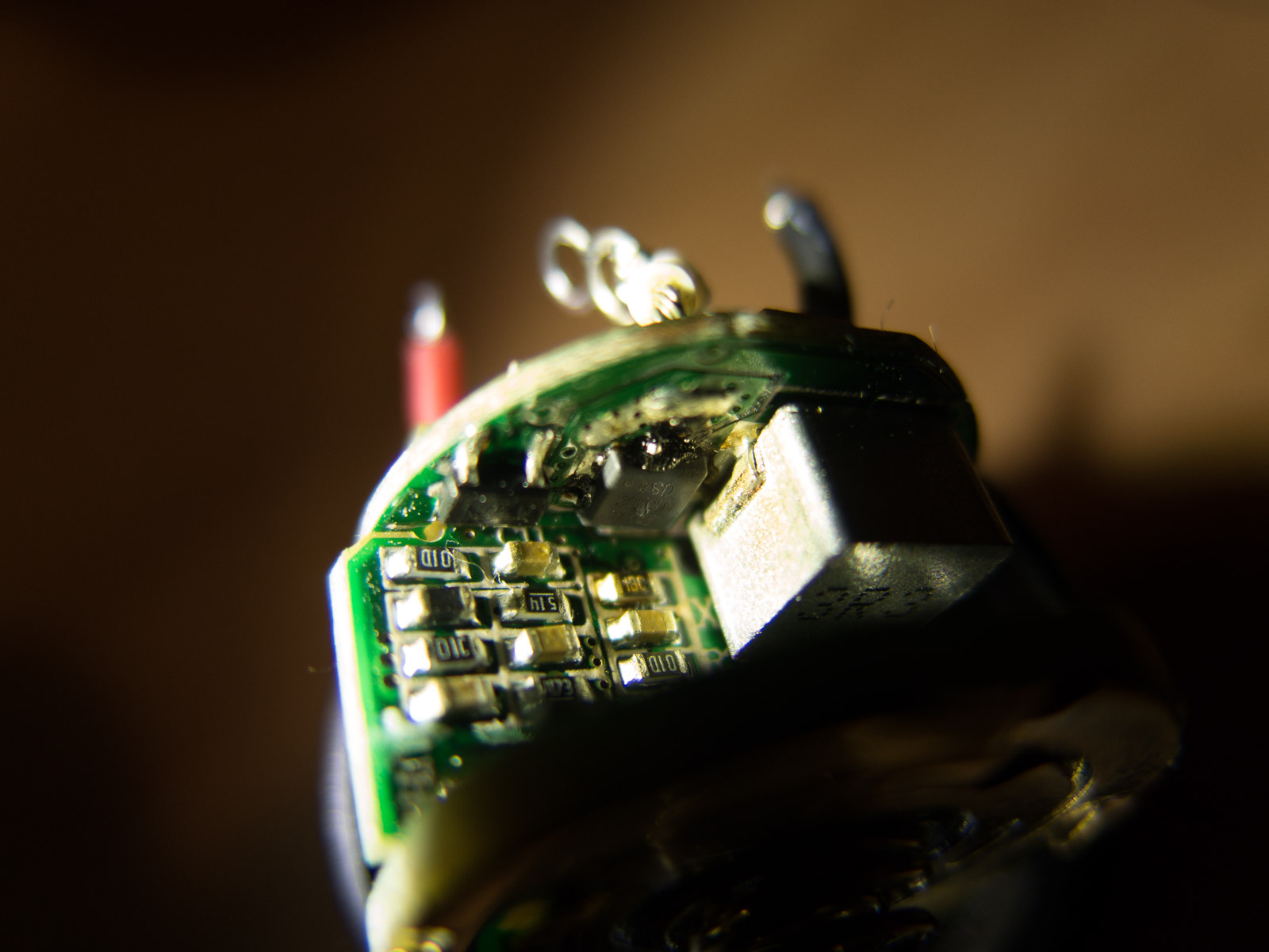

Help me identify this SMD part on driver
I think its a P channel MOSFET but google doesnt find it.
SD
3050DN
DL 02D
It’s labeled “Q5” on the PCB. The “Q” designation is usually reserved for transistors, so I’m gonna go with your guess that it’s a MOSFET. If you look at the traces and solder around the base of it, it does look like the way SMD MOSFETs are connected on our drivers. Whether it’s P-channel or N-channel I don’t know.
Maybe something like this:
http://www.ruichips.com/pic/RU3050L.pdf
