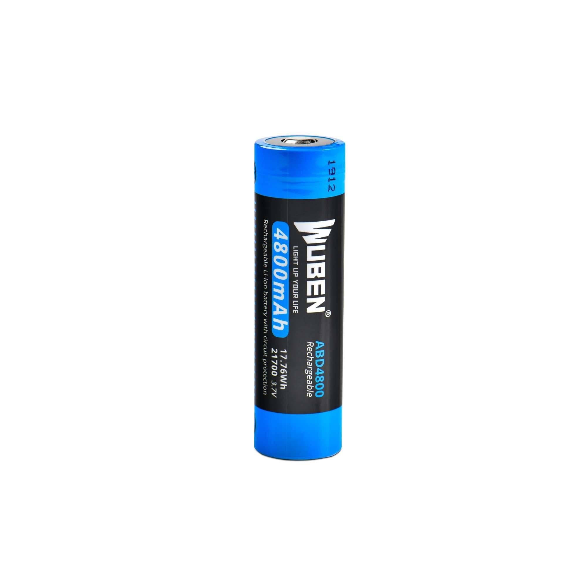

I have a Wuben TO50R with the original Wuben branded battery.
It is 3 years old and doesn’t keep the charge as long as it used to, so I am looking for a battery replacement.

Specs of the original Wuben battery :
ABD4800 : Protected 4800 mAh - 3.7V - 17.76Wh (printed on the battery)
