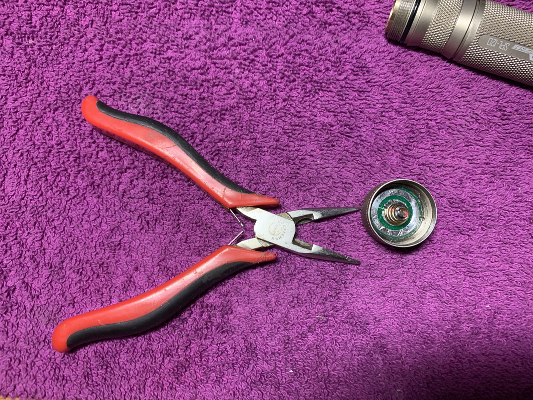

That can be done by a set of needle nose pliers. I use two SS nails, always does the trick.
$3.00 (small) Needle Nose Plier’s…………… Righty Tighty-Lefty Loosy……
This helps immensely…I have some needle nosers so I’ll give it a try today.

I’ve always used the handles off of a binder clip, never had any issues.
Yes I know that’s the head but it works the same.
Or just get this lol.
