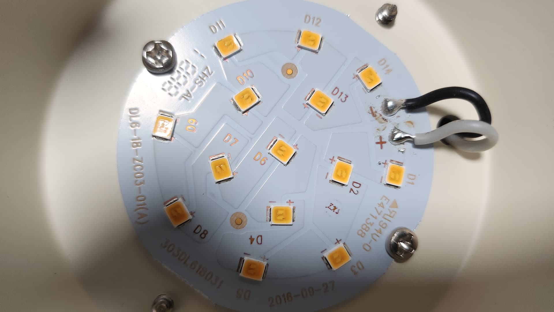

Hi all,
Would someone be able to identify the LEDs, and tell me if it’s worth salvaging the board/LEDs? The internals are kinda toasted, with 0 continuity across multiple components.
LEDs are in a busted downlight, discontinued.
Company: SHINE GLORY LIGHTING LTD
Model: BL-D6-13YYZZ
Driver: unknown
Input:120V AC, 0.125A
Power: 13W
Lumens: 1100
CCT: 3000k
Thanks in advance!
Looks like any 6V 2835 type LED would do, as long as they can handle 1W each.
Even 3030 emitters generally fit on a 2835 footprint, I highly recommend SunLike 3030s which are ultra high CRI and available in 6V on AliExpress for under $5 for a 20 pack.
I kinda wanted to try fanagling an anduril 2 portable desk lamp :3
**I want to say the site listed these as 90cri, they came out of a damp/dry rated fixture in the bathroom.
