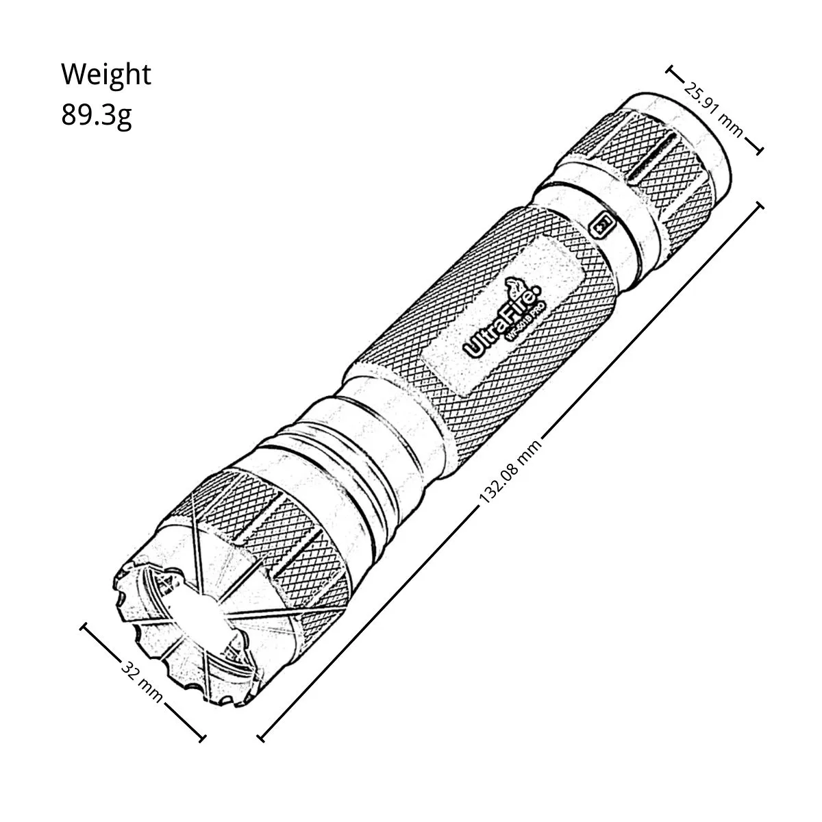

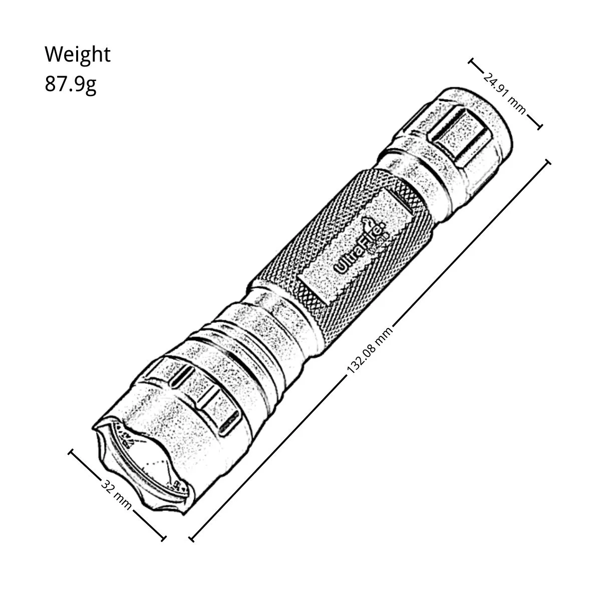

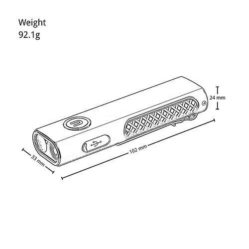

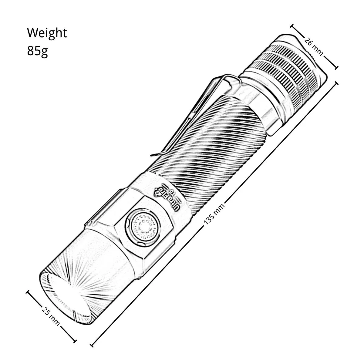

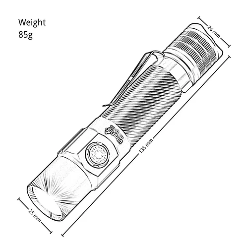

I’ve created dimension diagrams of the product using line art. I’m not sure if everyone is satisfied or if there are better suggestions I can improve upon.
If the weight is with a battery, as it should I think, it may be worth indicating it.
Also, but this is really nitpicking, for ‘weight’ (mass) it’s probably sufficient to report it with ±1g precision.

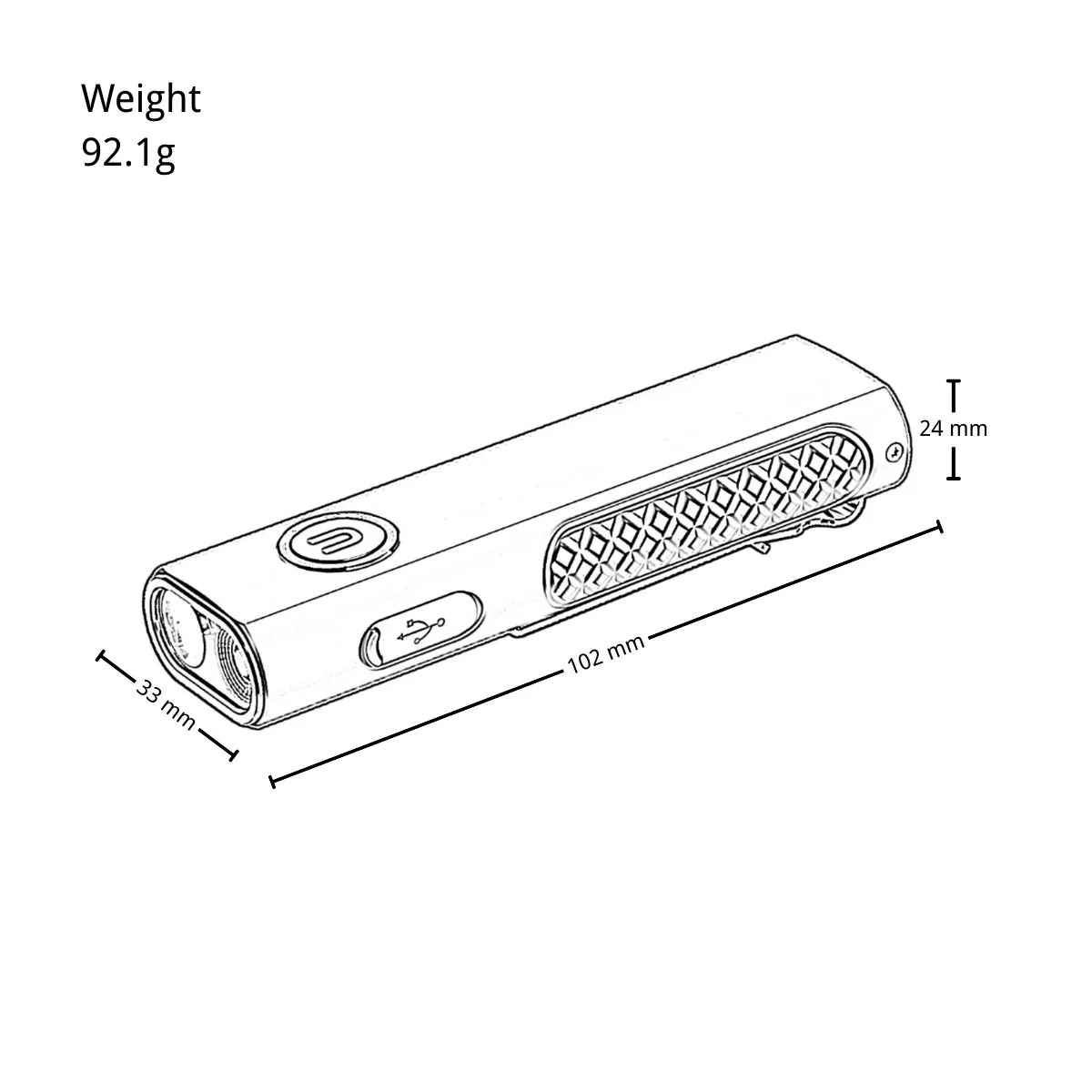

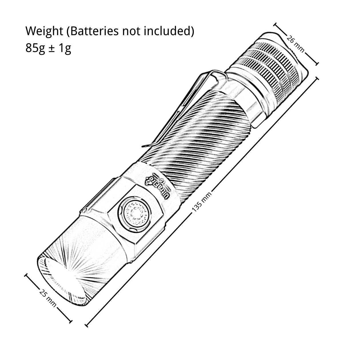

Understood!
Is this okay?

Yes. For those lights that you report with fraction of a gram precision (like 87.9 g) it’s probably more realistic and meaningful to round it off to the nearest gram i.e. 88 g or in a fancier notation: (88±1) g
I would advocate reporting total weight with a battery (some light can’t be reported any different as they have battery built in).
I guess the rationale behind it is that although I can always look up the weight of the battery, that takes some work and what most people would really want to know is how heavy a complete light (i.e. with a battery) is.
Got it—I’ll include both (with and without battery)! Thanks for the feedback, kind soul! :blush: :blush:
