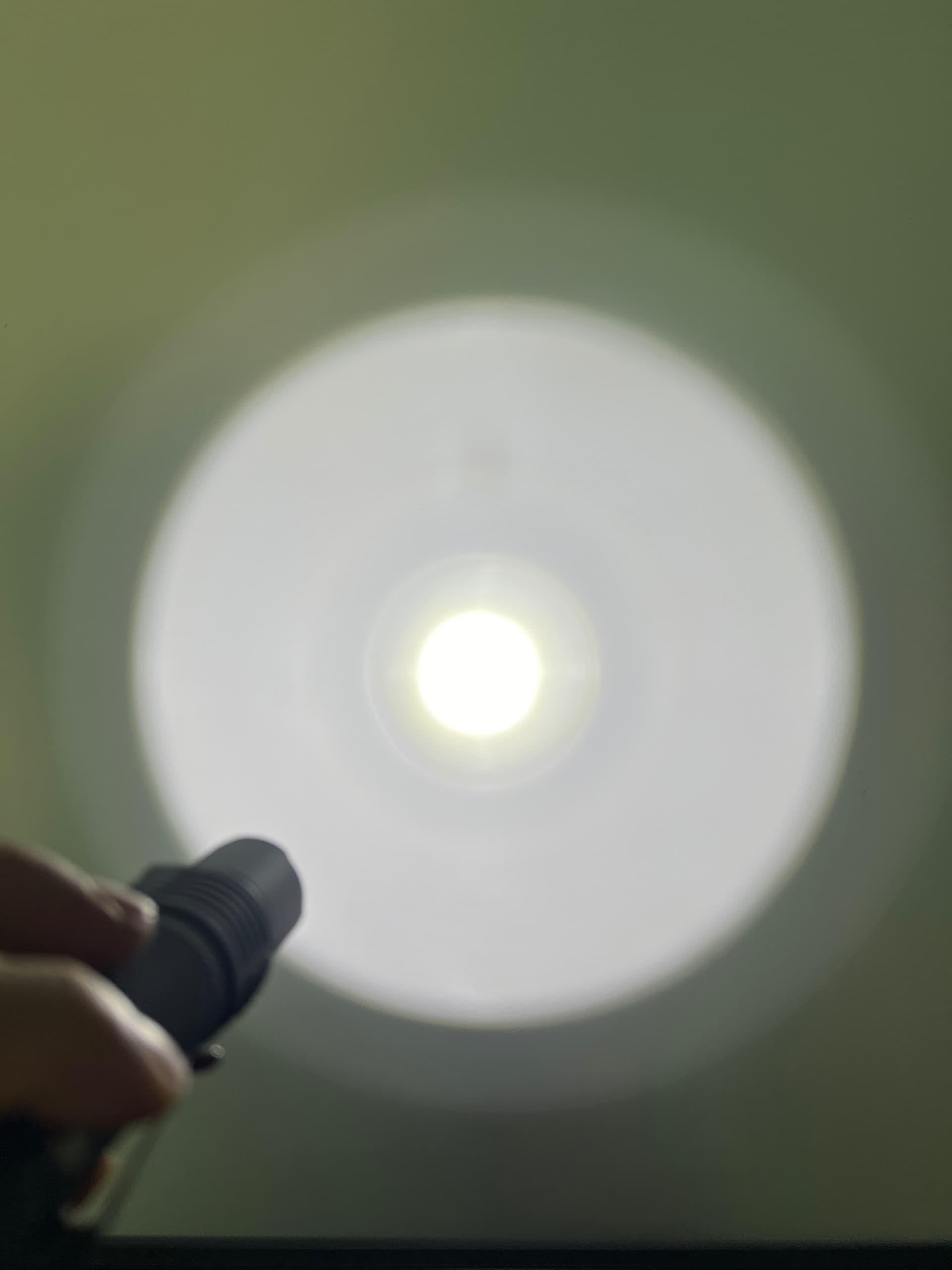

Well centered LED
:memo:Okay!
I also think well-centered LED is quite important. Do you think I should use a white wall to demonstrate my well-centered LED effect?

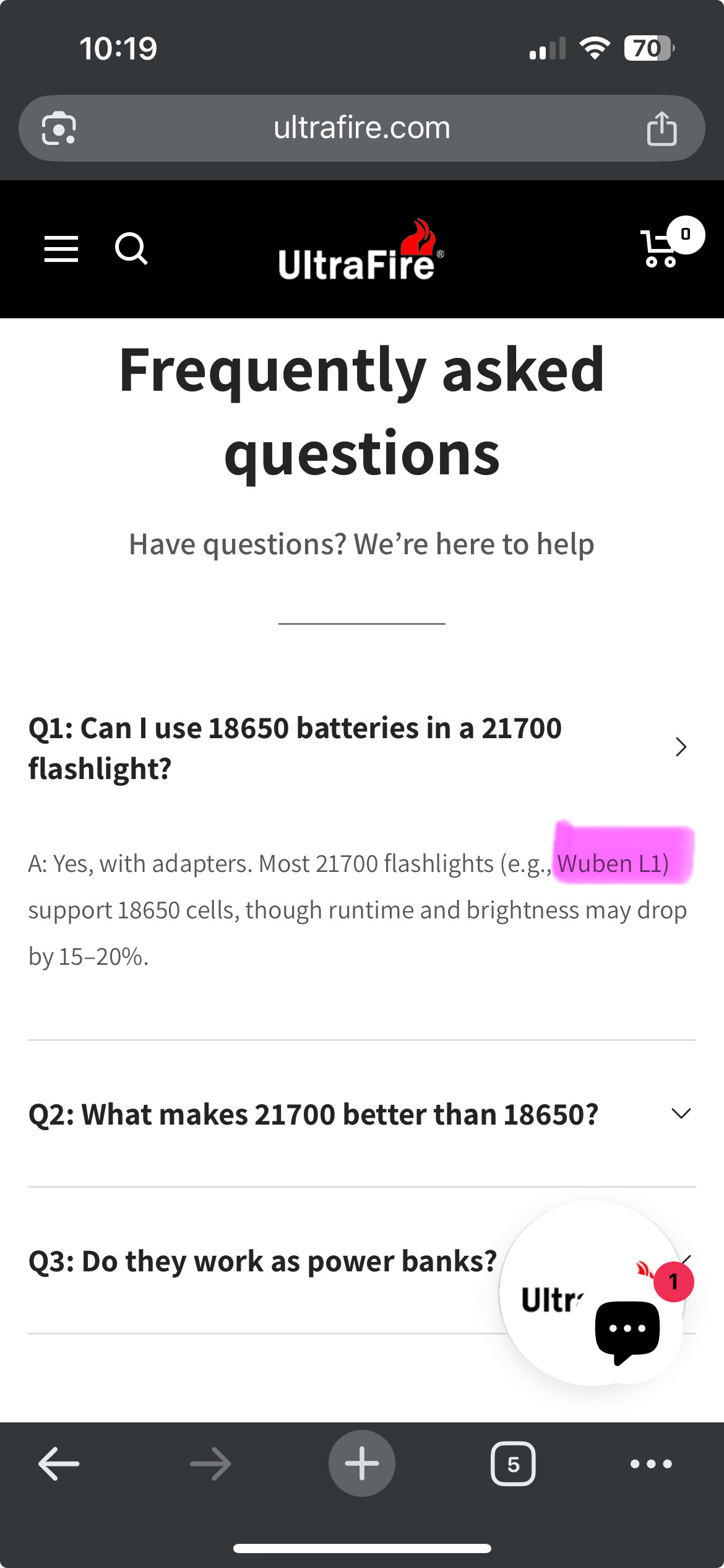

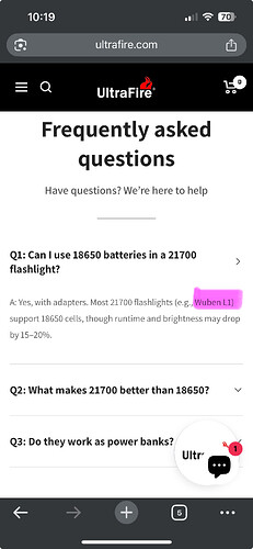

Not sure why you’re mentioning another manufacturer’s product in FAQ:

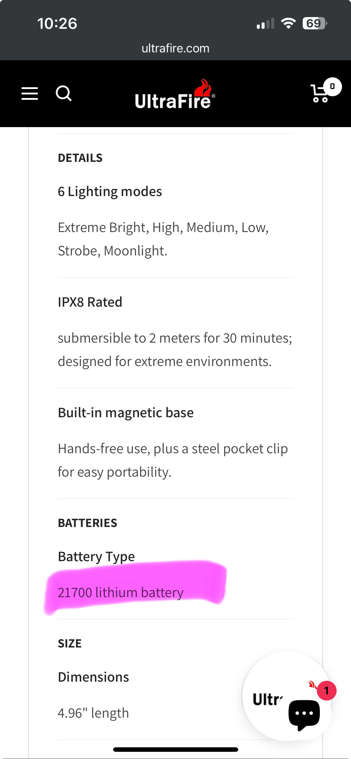

The EC1 is a 18650 light but the specifications say 21700:

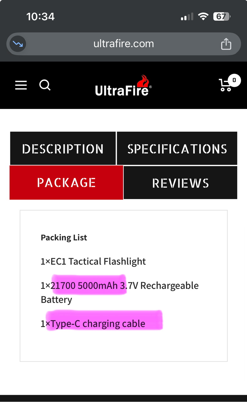

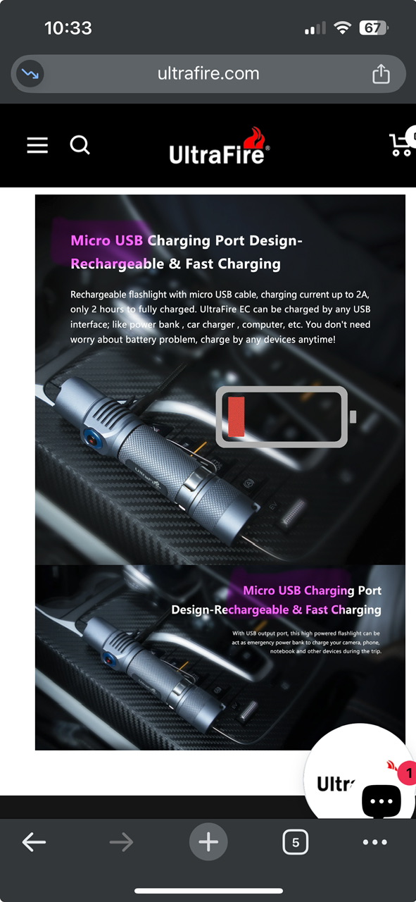

The EC1 product page shows it charges via Micro-USB but the package shows it comes with a USB-C cable:

FAQ issue: Likely caused by unedited AI-generated content. My apologies — this has now been corrected.
EC1 uses an 18650 battery (apologies for the earlier TP1 battery-type mixup).
At full charge, it reaches 1500 lumens.

The studio is out of EC1 units right now, but I checked with a colleague and might be able to get one from her. I’ll take photos and videos to show you — just let me know if you need anything else!

I’ve taken some photos, and I don’t believe it even reaches 1000 lumens. This is a fact. I will have them remove the false claims and update the information. Thank you both for your help
