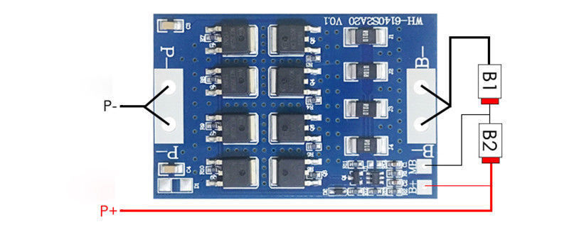

I need some help with rebuilding a 7.4v lipo battery pack for a coworker’s drone that you can’t buy parts for anymore. It all started when my coworker brought in the battery pack with charger saying that the charger just kept flashing the red light when he plugged it into a usb port. I started trying to figure out what was wrong with it by poking around with a DMM and figured out one of the lipo cells was totally dead. I then went online and found 2 new lipo cells of about the same mAh rating and soldered them in, still didn’t charge the batteries. I then ordered a new Lithium Li-ion Battery Charger BMS Protection PCB Board figuring maybe it had gone bad when the dead cell did. I just soldered in the new board according to the ebay listings picture of the wiring diagram. I plugged it into the charger and still same results, red light flashes. Does anyone here have any knowledge/experience with this kind of thing? I hooked up the batteries like the attached picture below. I measure 3.8v~ between BM and B-/B+ and 7.4v~ between B-/B, but no voltage between P-/P. Should I be able to measure voltage at P-/P+?

@chops728 your diagram is a little different than the circuit board I ordered. I have attached some pictures to hopefully help.

Your measurements between B-/BM and BM/B+ are correct —— not sure why you’re not getting voltage at P-/P+ —— sometimes you have to put voltage to the P-/P+ to wake up the BMS —— Also you’re using the old board for the plug — are you sure have voltage across the 2 pads you soldered to on the old board when trying to charge the battery
Also why do you have that blue wire going to the old board — with the new BMS you shouldn’t need that hooked up
If you had an adjustable power supply, you could tap into the P-/P+ wires and set it to 8- 8.4volts to see if it charges

Ok so I have successfully charged the battery pack with my power supply at home. Now my question is how to charge this battery once I give it back to my coworker, anyone have a suggestion?
I charged the battery from the positive and negative on the drone connection which is basically the P+ and P- on the new circuit board as seen in the pictures above. I charged at a maximum of 8.4V at 500mA while making sure the batteries didn’t get hot and charged evenly.
So you know the connector is letting the charge in —- I would think the original charger is dead or some lind of way isn’t being told to charge the cells — you could just make up a new charger with 2 cell charger and just put the old charge connector on it
