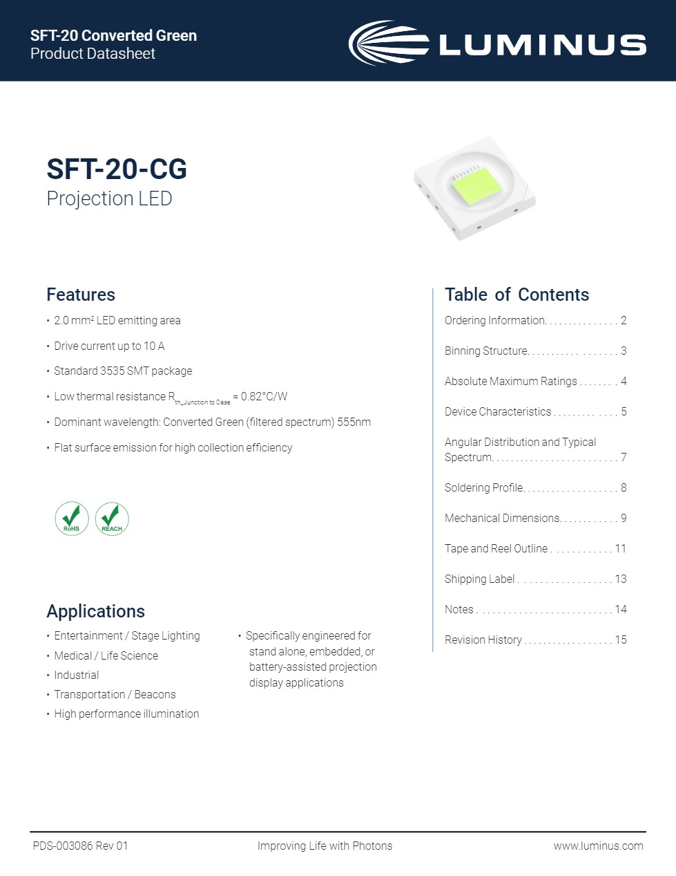

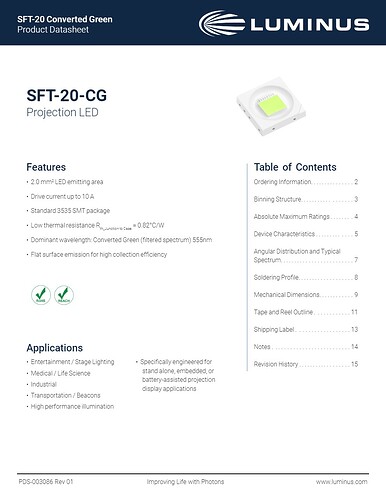

No, the m21f use a special double deck side switch driver, which is different from other tail switch model. I think it’s best to stick with the new light if you’re buying one, or bet on luminus to release a sft-25r green, they already did with sft-10.
edit: just realized they already did with the SFT-20-CG which can be driven up to 10A. You might want to take a look? :wink:
yay! and so the dream of a green M21F lives on man! tq so so much!
