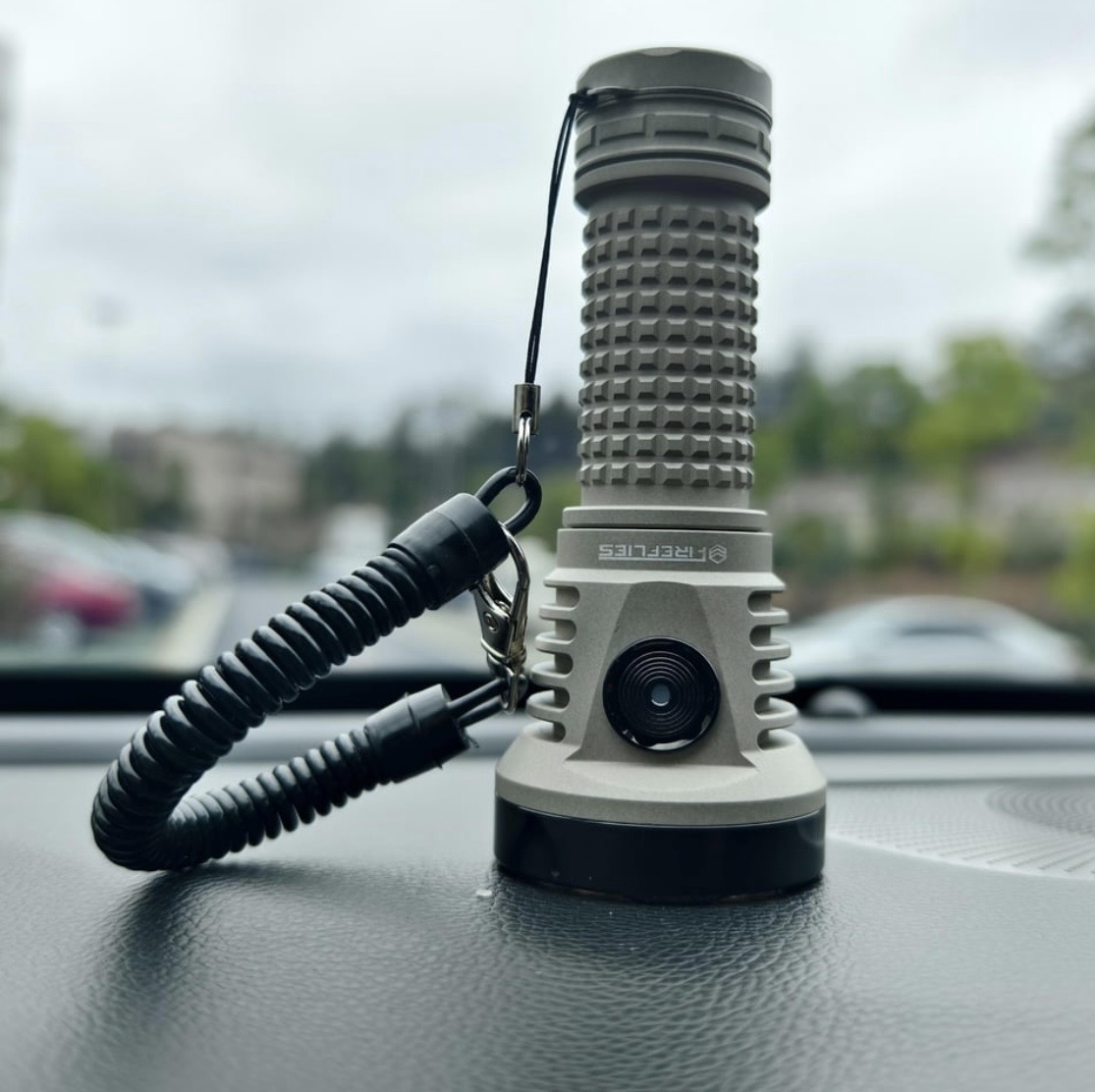

I’ve been away from BLF/flashlight for a couple of years and have forgotten functions. My grandson found my E12R flashlight and started playing around.
Now, the light comes on High (or Turbo) immediately upon pushing the power switch….and does not dim, or change, upon holding the button….stays on High/Turbo ONLY. Unscrewing/disconnecting battery does nothing.
How do I reset to default? Thanks for any info :double_exclamation_mark:
Here’s a review, check the UI section for all the controls. A factory reset should be (from off) 13 clicks, hold the 13th. =13H
If I remember right it’ll flicker fast and get brighter, then go off. Reset complete.
Maybe worth taping the battery terminal or removing it if young hands can get hold of it :+1:
Ok, after fiddling a lot, got it to do the acceptable (5) STEPPED RAMP lighting mode :+1:
Now I am trying to get it to the SMOOTH RAMP mode….it says 3C from ‘ON’ but that’s not changing it. Tried 3C from ‘ON’ many times, but no change from ‘Stepped ramp’ :man_shrugging:t2:
At least it’s working! Appreciate the help!
EDIT: OK, I GOT IT :index_pointing_up::smiling_face_with_sunglasses:. After the reset, it’s in Simple UI…..to get the RAMP to switch it has to be in Advanced UI (which was a 10H move). YAY for me, almost wanted to chuck it into the drawer.

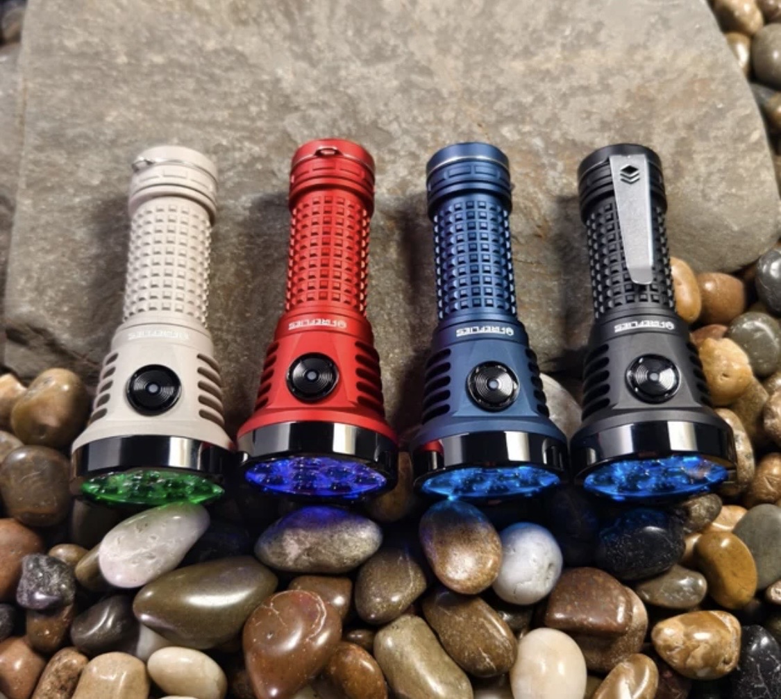

Erm…as a fellow ‘keep it simple’ fan, I may have found the method I’d favour to upgrade the firmware. :wink:
Upgrade the light, FireFlyLite just announced the new E12 Eclipse.
Ahhh, you bastid….now I can’t unsee that new light :cold_face:
I’ve been out of the flashlight scene for 3-4 years…..I admit the lure has me reading and scoping out new flavors, again :sweat_smile:
WB, Erion929!
:joy: It was meant to be…:wink:
Such nice ano on these new models too.
