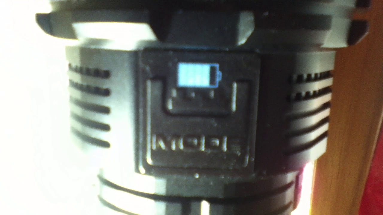

My couple year old DX80 is now holding less and less charge each charge cycle. I’ve attached a video below which depicts the exact same symptom that my DX80 screen is displaying.
Flashlight begins charging correctly from dead or low voltage. Fully charged voltage is 16.8v. the flashlight charges normally until 15.5v or 15.8v and then displays the weird error message shown in the video.
I’ve tried cleaning all contact points and using a different power adapter.
I can’t find anywhere online that sells a replacement battery pack.
When it charges to 15.5v I can turn on turbo for a couple of seconds and get it to charge up to 15.8v but nothing can be done to charge it to 16.8v fully charged

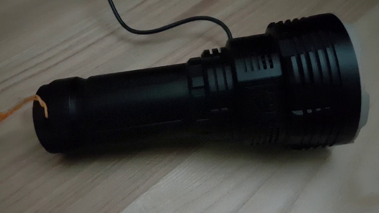

I took a video last night (I know it’s long but had to show what was happening)
