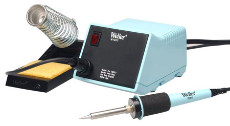

My personal favourite is the ancient Weller WTCPN or the newer WTCPT. As far as I know they still make the WTCPT. A new Weller will cost more than a 936 clone but it is much better.
Both turn up on eBay all the time. If you get an eBay one, be sure to replace the tip. The temperature control is in the tip. The magnestat sensor wears out and needs to be replaced occasionally.
I’m still using the WTCPN I bought new in the mid 1980’s. I also have a WTCPT I bought in the UK because I needed a 240V power unit.

A brand new genuine Weller WTCPT is $159 from Parts Express or $134 from Newark but on Back order.
If you can manage it, get the new Weller. It will last 30+ years as long as you are able to get new tips.
They are bullet proof and fool proof. The temperature is set by the tip. Tips come 600 / 700 / 800 F Just turn on the iron and go.
I use a single 700F tip most of the time.
