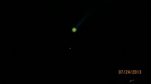

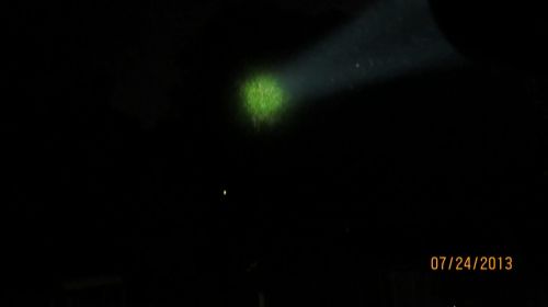

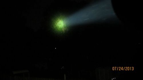

I got some beamshots of vinhs modded 6.5 A tn31 vs a dedomed t40cs and a xseacher with dedomed epe2 @ 3 A
Vinh modded tn31………………………………………………………………………………….dedomed t40cs also done by vinh
xseacher with vinh dedomed xpe2 3A pill
Distance to trees is 150 feet
