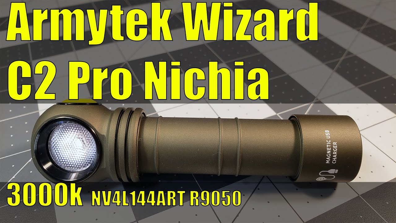

If in the US this may work.
Armytek wizard pro nichia 3000k.
3 firefly levels to choose from. The lowest one is probably too low. The second level at 1 lumen may be good. The third level at 4.6 lumens may be too high. Only available in the US.
None of the above lights will offer a crisp shadow, and seem a bit expensive for what they offer.
I’d recommend the Convoy T5, which is a TIR-based AA light with warm high CRI emitter and moonlight mode. It functionally has basically everything the Reylight has, but at 1/3 the price, and a choice of even warmer CCT than 4000K–the T5 can be had in 519A 2700K. Also you can get a pack of different TIR lenses to fine-tune the beam profile, and any of them will look much, much better than the reflector that the Reylight comes with.
The T5 is a TIR-based light like the Armytek recommendation above, but with a smaller TIR (and a choice of various beam profiles) which gives you more flexibility as mentioned above, and thus a better chance of getting a crisp shadow. Also, the head can actually unscrew during operation to reveal the bare emitter, which will cast as sharp a shadow as is physically possible.
