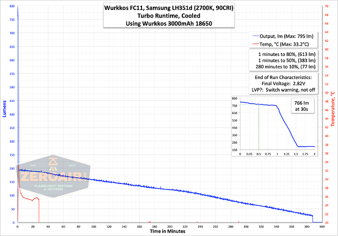

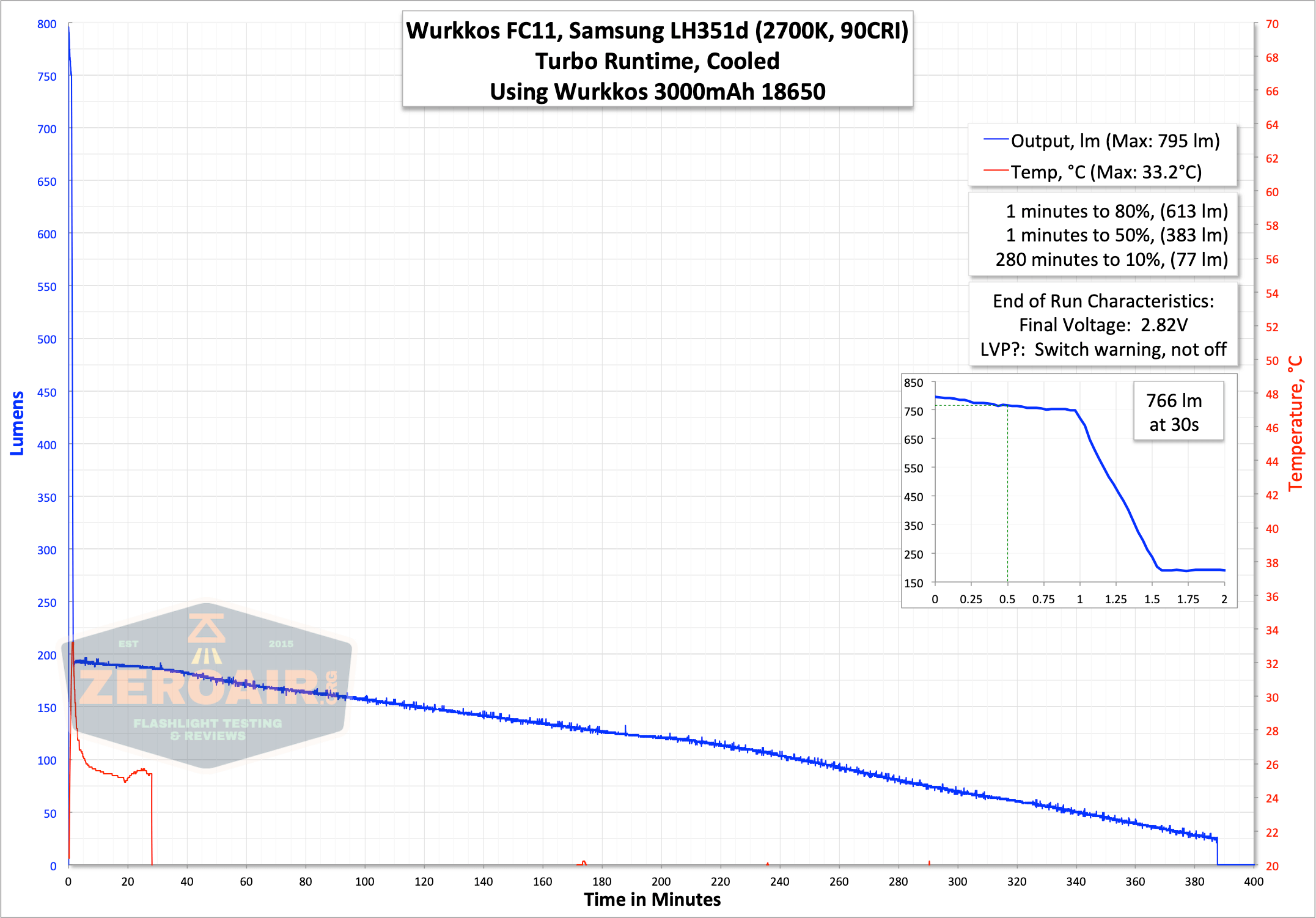

I did not find a runtime chart for the FC11C, but here is one for the FC11
notice how after the initial Very brief turbo, the output drops to about 300 lumens
3A discharge works fine for me, I dont use more than 500 lumens, the majority of my use is below 200 lumens. My personal use pattern is focused on sustainable outputs at indoor distances, with long runtimes,
I am not a Turbo user. Brief unsustainable outputs that constrict my pupils, and quickly step down to 300 lumens and less, are not my priority. I can do without the bright flash, and go straight to outputs that are sustainable.

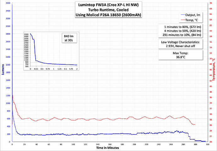

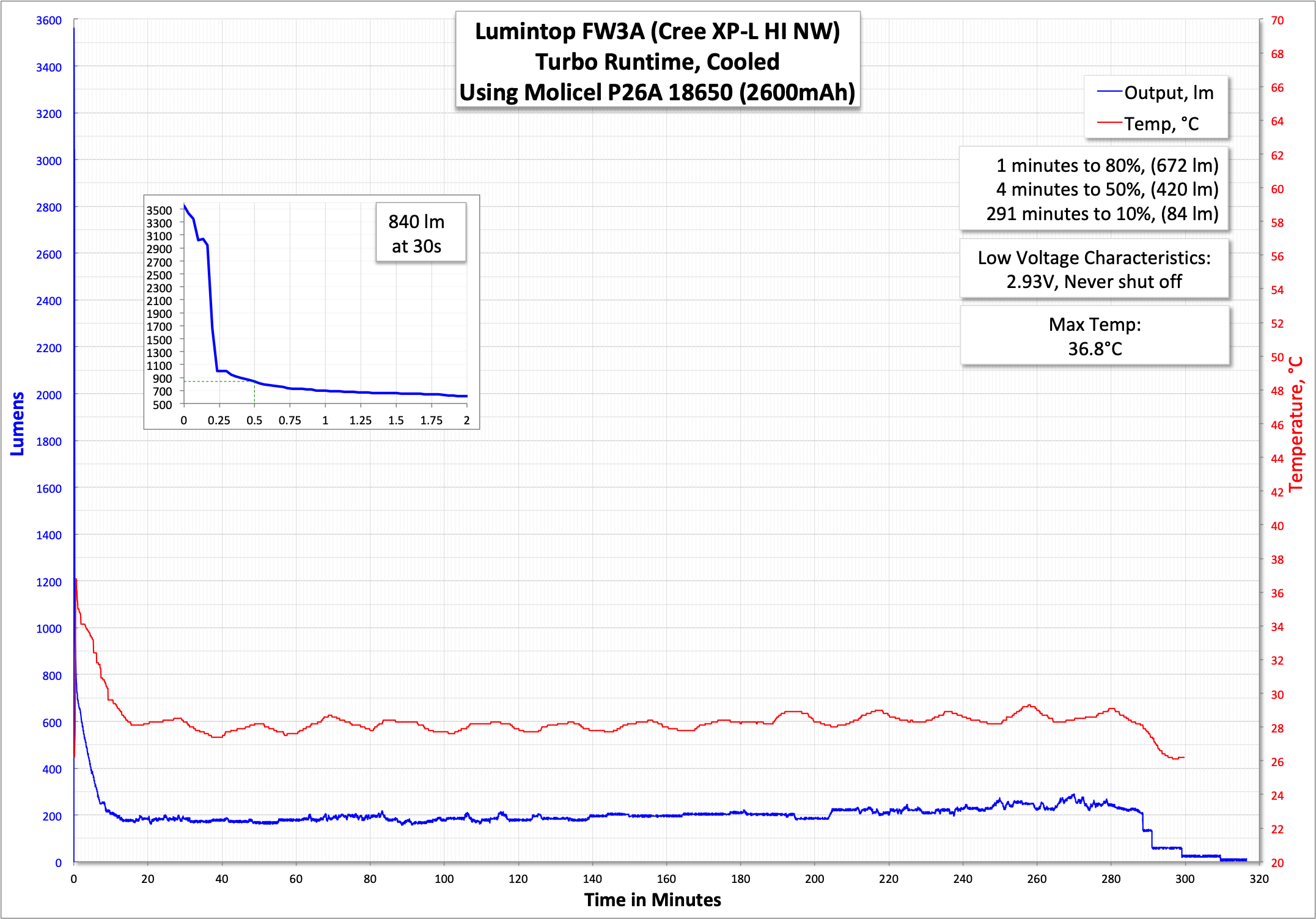

Here is what the discharge curve looks like w 18650 on a stock FW3A… note that after Turbo the output drops to less than 200 lumens:
(that 18650 battery has a 35A max discharge rate)…
To me, Turbo is a waste of battery capacity :wink:
