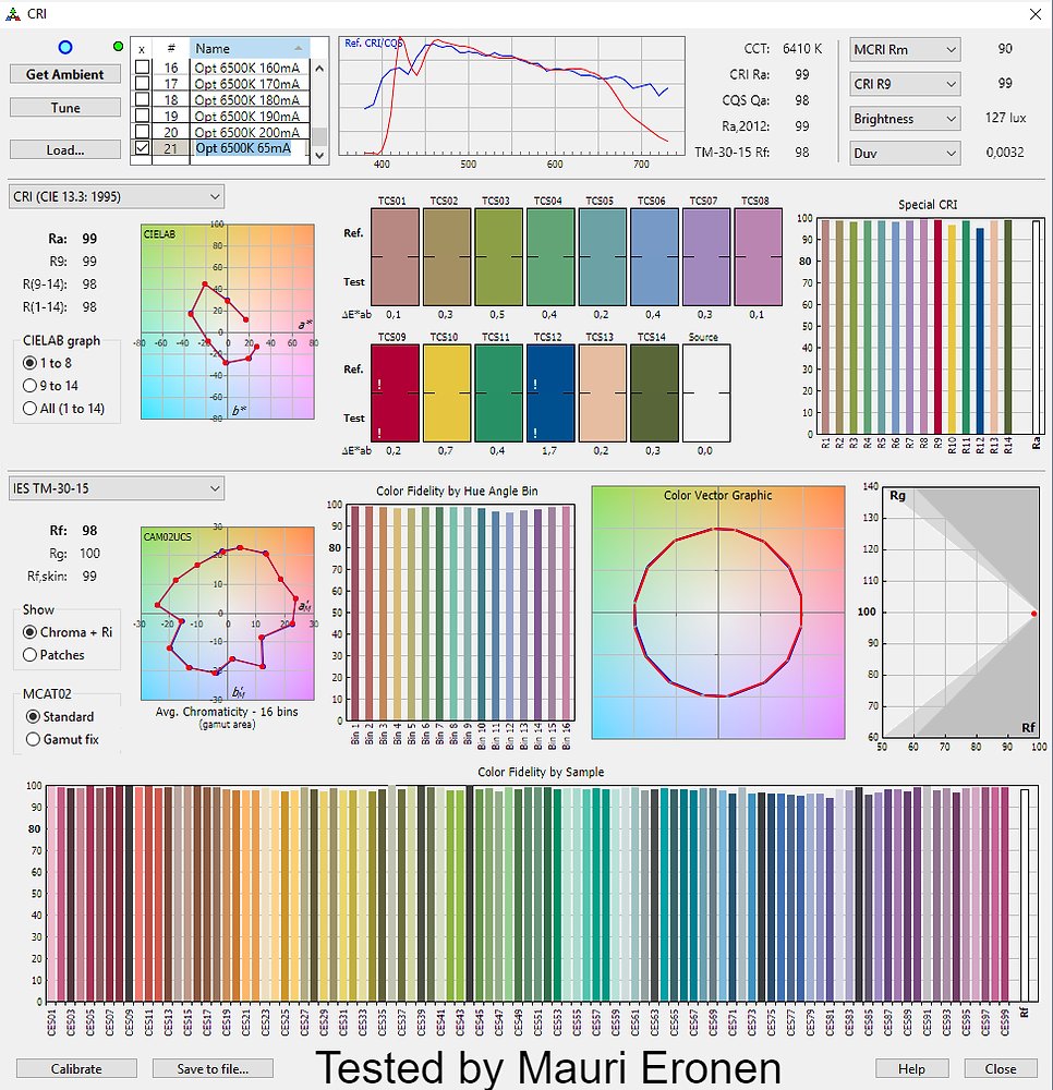

The ones I am currently using now to make a quad is the nichia optisolis 6500k which is able to fit in a 3535 quad mcpcb, abeit having to insulate the whole mcpcb due to ground leaking through the center pads, plus its like 200 lumens per LED max?

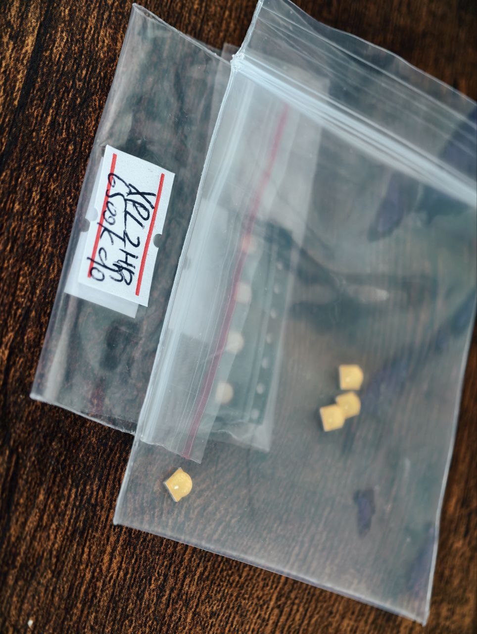

The issue is that i recently just bought 4x XPLs in 6500k 90 cri from KD, when i compared against my other batch, its 5700k, nowhere near 6500k, in fact there was another reddit post where someone mentioned they bought some from KD as well, tested it to be 5700k (confirming the same result as me)
I bought the other batch from taobao, also supposingly labelled 6500k, using a UV light, the phosphor color is exactly the same..

KD pulls this shit all the time. I’ve had several orders with incorrect CCT or CRI.

These are still one of my favorite LEDs! Despite not being that bright and blueish, they are incredible for CRI! And I think they are still the CRI king:
Good luck with your search.
Hmm not sure, just prefer it, been using 5700k as long as i can remember going back to 219c days, ever since I got some optisolis from virence and put it in my sundrop i’ve been sold, it just makes all the rest look very warm and yellow :smiley:
i think fireflies used to sell a 3535 version of their 6500k high cri emitters, now just no longer sold, if you check jlhawaii’s firefly page, you can see the option is there, but greyed out.. the current best now is still optisolis that will physically fit in 3535 (plus insulation)
Yeah exactly! The tint is just beautiful, its really similar to the B35AM, i like it so much i’ve converted a few of my lights into either optisolis or b35am, it just sad that optisolis are really hard to come by nowadays, the closest are the sunlike, but its slightly greenish compared, nichias are more rosy
Aliexpress still has SunLike for very cheap, the 5700K is more like 6000K+ in practice.
If you’re after extreme CRI, forget about rosy tint. High CCT light at 100CRI is naturally greenish, on the order of 0.003duv. At this CCT, I also find a slight greenish tint more pleasing than a slightly pinkish tint, which blends with blue and washes out colors.

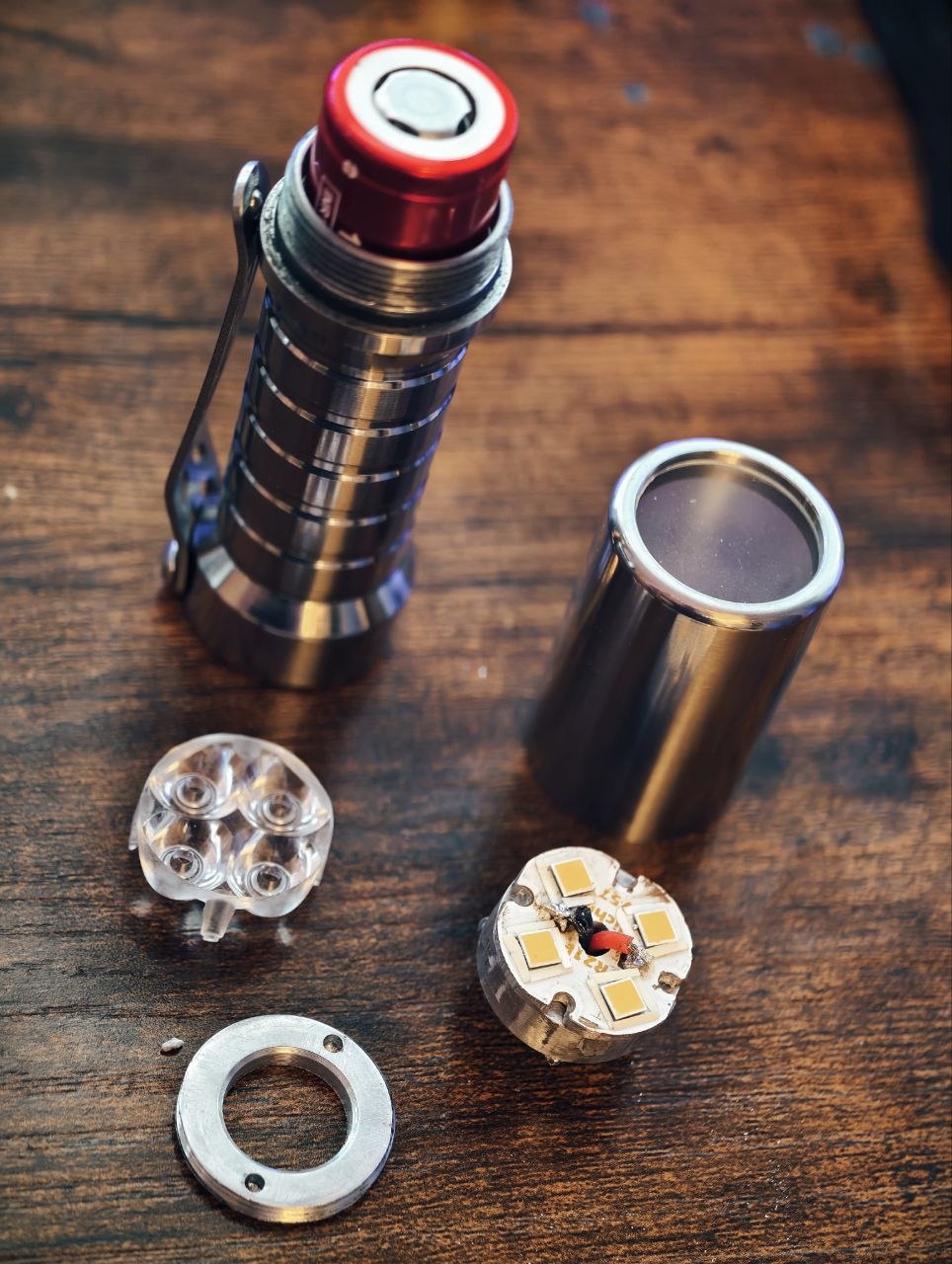

So currently this is the best i can get for now, a mac long head running 4x B35AM on a virence optisolis pad with a convoy 6v 4A boost driver.
Because the B35AM has no thermal pads, I need to run 4 of them in order to not burn them out and yet be bright enough
A vapcell 18350 M11 apparently is not enough to sustain the higher modes so a vapcell K15 18500 with 15A CDR had to be used instead to power the light and itworks flawlessly..

For the LM10, I was contemplating trying to find a replacement driver that would allow it to boost to 6v, but i don’t think any compatible drivers exist out there, the closest I could find are noctigon drivers, but those use a side switch not a tail e-switch
So as of now, its stuck using a comparatively weak Optisolis, i guess maybe 500-800 lumens max output, the only other solution without the B35AM is to make a custom quad 5050 setup to fit the next best candidate, the fireflies FFL505A..
