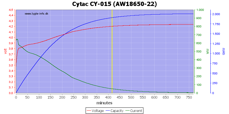

From your reviewed chargers collection, please do you have any example charger product in mind?
The last time i checked there was no charger which continued the 4.2V-CV-phase down to 1mA or 0.1mA "untermination" current :p
i must have overlooked them, thank you for the pointers!
yes these cheap chargers don't look too good. Cytac, Trustfire, Fire can be Trusted
the voltage is clearly over 4.20V. these 2 chargers are overcharging and wearing down the batteries!
The voltage is within range, the current is not.
