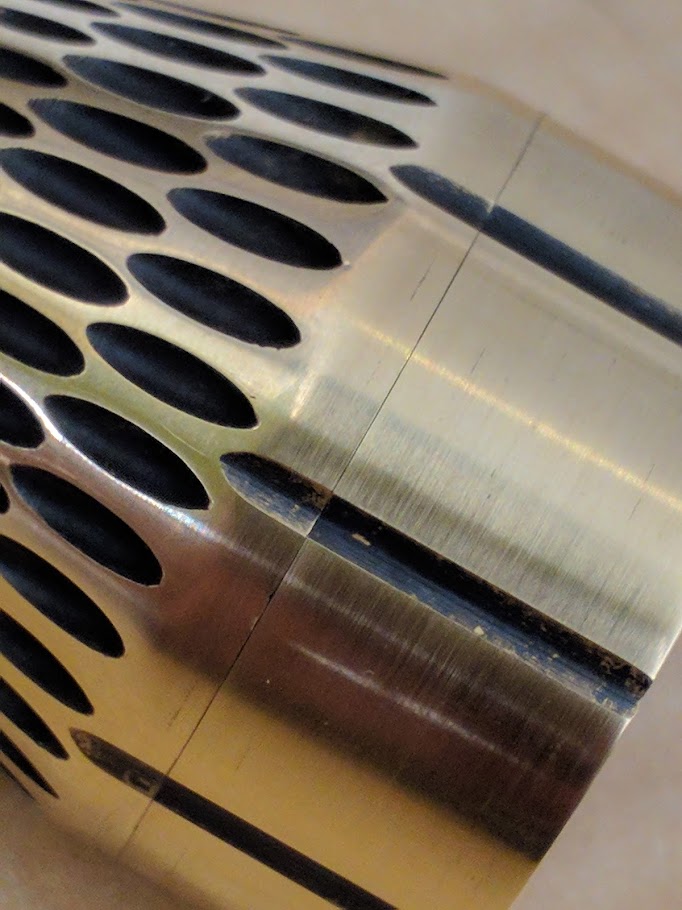

Before and after blackening
The jax blackener is not really wear resistant. After a few on/off’s with the bezel you can see the black is starting to wear off.
