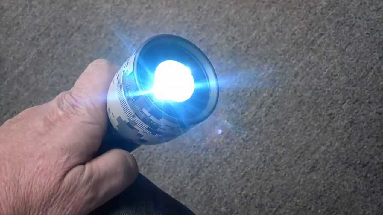

Here’s mine… a 2D maglite modded with 4x XM-L2 and carclo optics and a FET driver. 4,000+ lumens! My first Maglite mod!! 4x XM-L2 & Zener modded BLFDD . *DONE!*

I have done MTG2 on a three cell 26700 using HX-1175b1. Have several Maglite builds latest below.

I have it in a Mag 6C.A CUXM2 one mode at 3,04A Run with 4 AA NiMh eneloop pro. The only main problem is the heat dissipation. The gap in the head of the flashlight must be fill with alu or copper foil.
