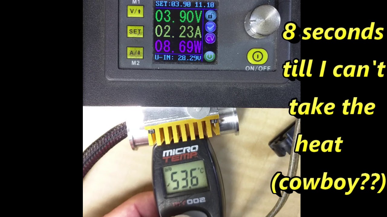

A quick test on the power supply and it sucks all the amps it can get :smiling_imp: I’ll have to be careful with this one
The battery box also needs upgrading so hopefully I’ll get time this weekend to finish this project :disguised_face:
