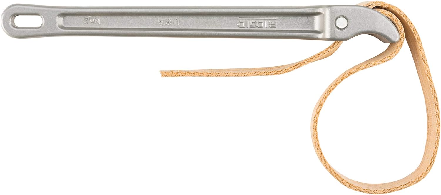

Last night I ordered 2x Ridgit 18" strap wrenches that will come Wednesday via Prime. So I think I will get it open then.

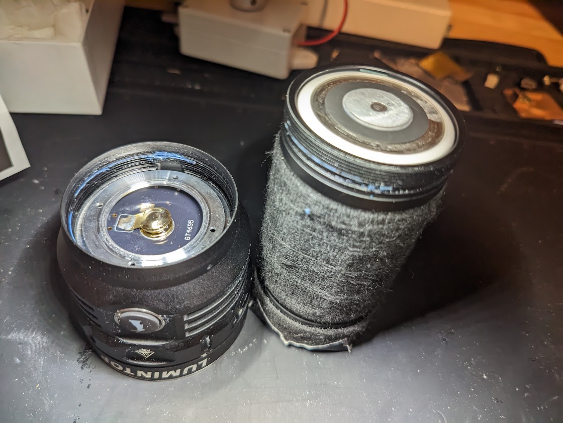

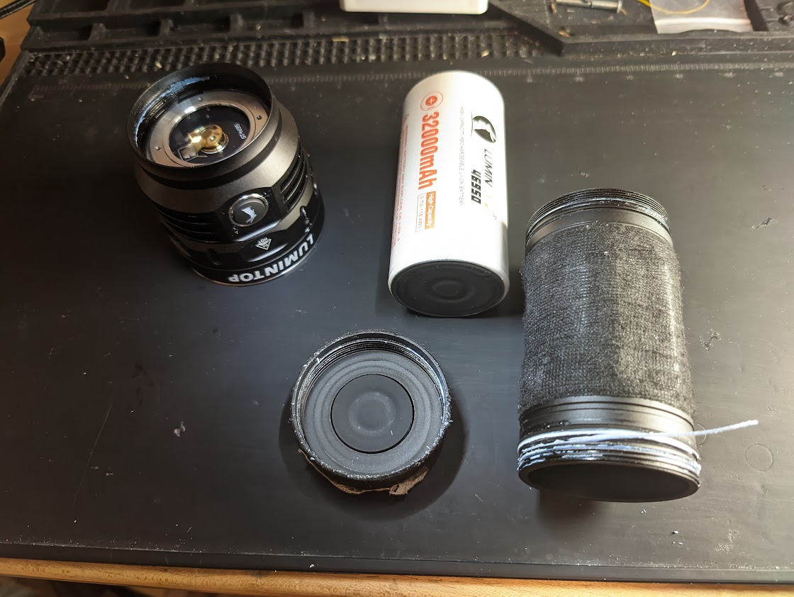

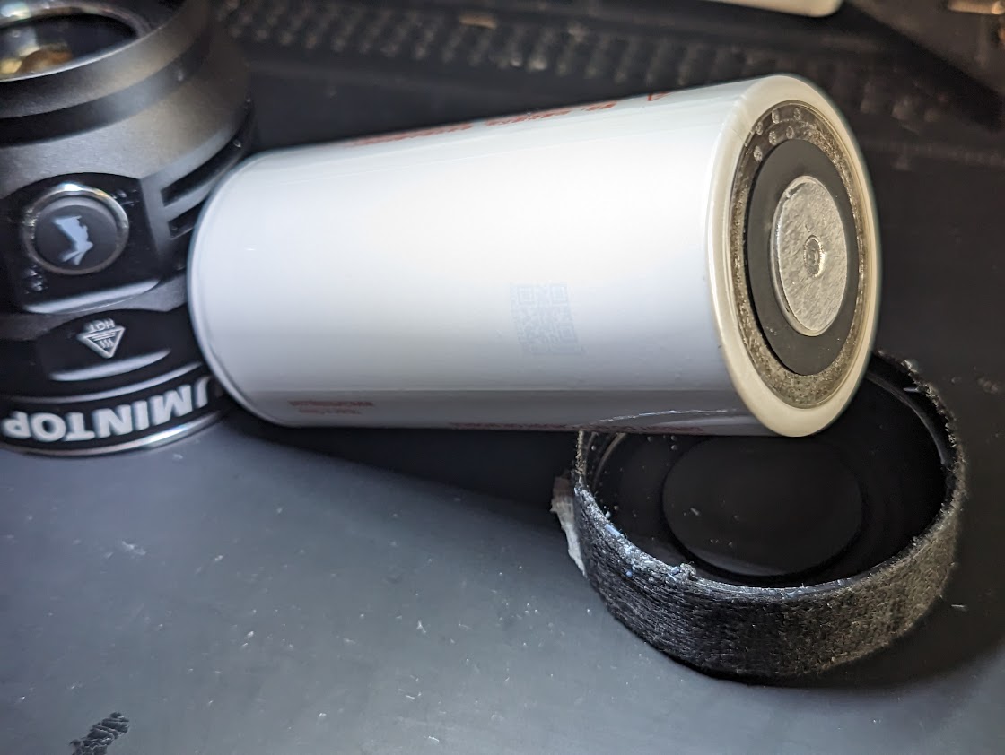

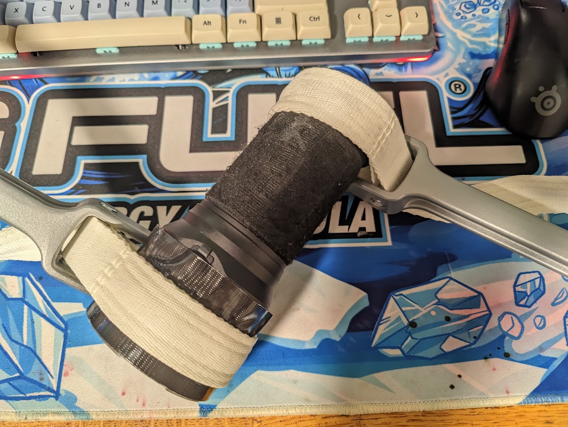

So the strap wrenches worked.
It was extremely hard to break the threads, even with the strap wrenches. Duct taping the components helped get a grip. It appears that the threads had a crap ton of blue thread-locker, but hardened like red loctite.
