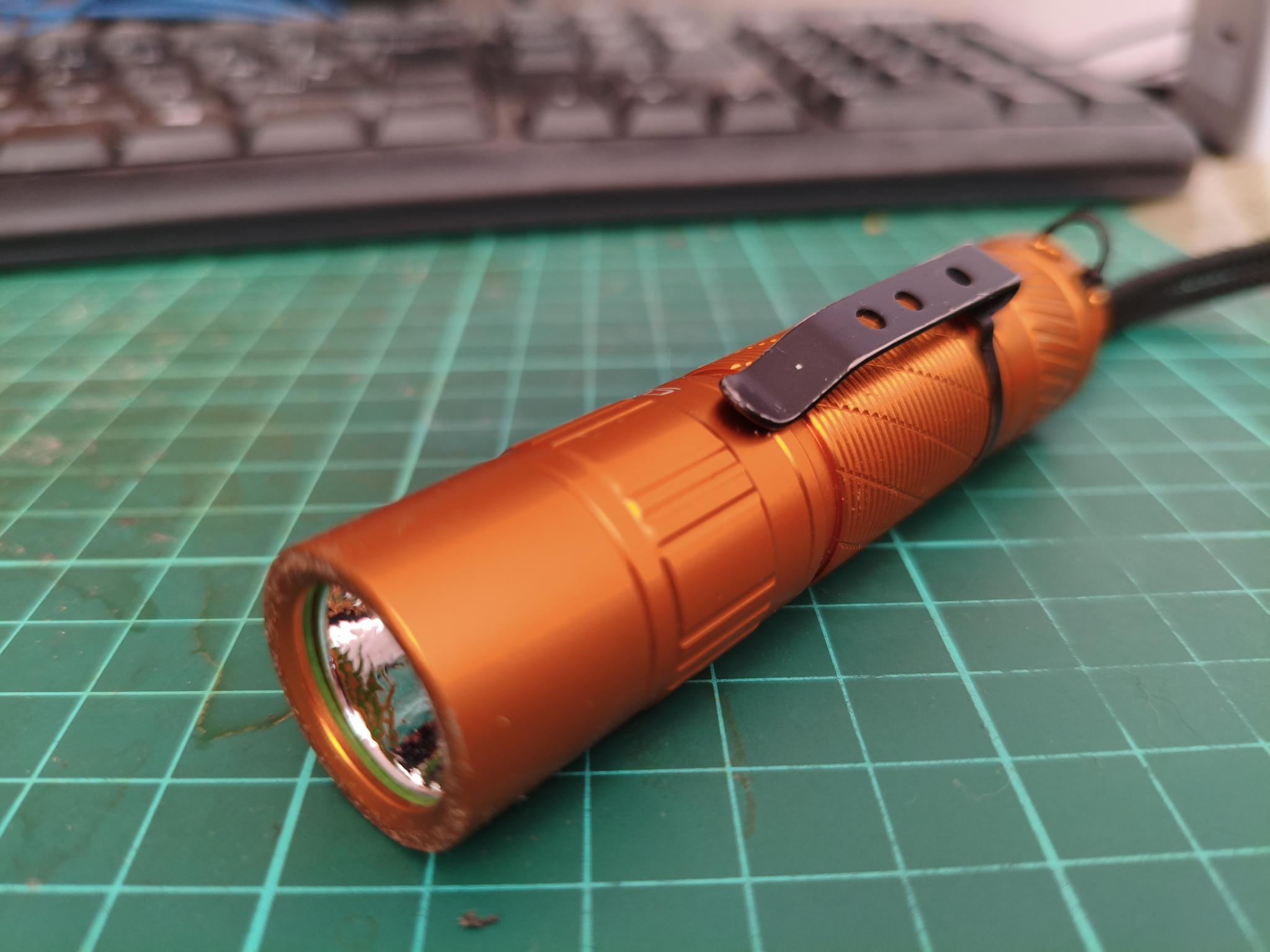

How can I fix this Convoy T3?
It stopped working a couple of weeks after I bought it and the seller said at the time to send a video to prove it. I never got round to doing that though.

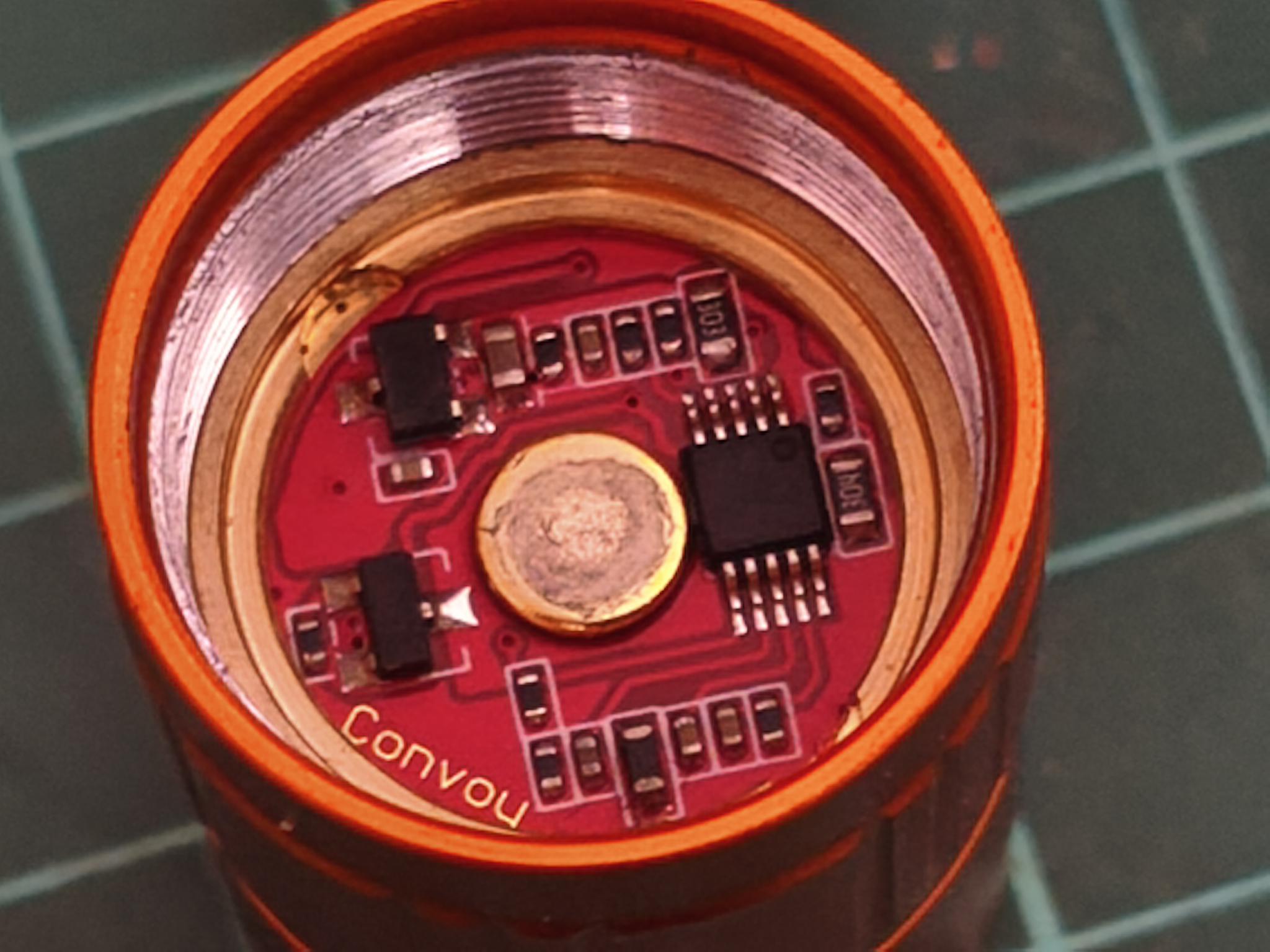

I tried an end cap from another T3 and that didnt work so presumably it’s a fault on the LED board?
Mine failed like that. I plan to grind down the MCPCB and put it in another flashlight.
I think it’s a driver issue but haven’t done any actual troubleshooting.
Can you get new drivers? I wonder if this was a common failure.

Interestingly the driver in my light is different to the ones currently available.
I have this driver in both of my fairly new T3:
And yours is this:
I chose the cheaper one because I basically only bought them because they look nice (brass and camo)
Have you tried to clean the brass battery post on the driver to see if that helps? It looks like it got corroded or something is covering it. You may also want to sand it down with some light sandpaper.
And have you checked to make sure the driver is tightened down well with the retaining ring?
I have the same driver in my copper T3 that I bought a couple years ago and it works fine.
The 5A driver has one more advantage: When the battery is low, it automatically switches to a lower level, giving you warning and the time to use it at a lower level. The default T3 drivers just dim out when the battery voltage drops.
It looks pretty battered up for a couple of weeks of use. Looks like you’ve dropped it more than only once so I’m assuming the driver is cracked and not making contact inside of the pcb.
Well I use my lights every day as I’m an asbestos surveyor. I probably did drop it. I expect my lights to survive the odd drop otherwise what’s the point? This light was used out in the field on the front line.
And yes the contact looks like the gold has come off and you can see the copper. Bear in mind it hasn’t been used for a couple of years since it stopped working. It suddenly stopped working though, one day I tried to turn it on and nothing. Been like that ever since.
Try loosening then tightening the driver retaining ring. I gifted a T3 to a friend who had it stop working, and this immediately fixed it.
