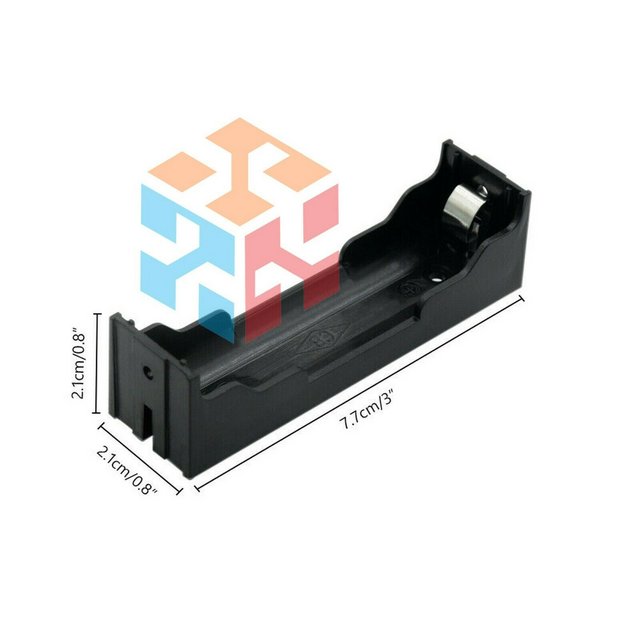

I don’t see anything that looks like the controller module. Maybe there is something on the other side. The one I looked at is only about 3mm across and less than 1 mm deep. As to the battery, if there is room enough you could put in a single 18650 battery holder like this one
I bought a bunch of them from China for around a dollar each postpaid (before the USPS raised rates). If that is too big to fit, buy a battery with the tabs already attached and solder the lead to the tab.
