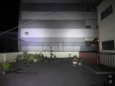

XP-L2 seems to be able to reach higher brightness than LH351D.
Eg. The Sofirn SP36 comes in both 4x XP-L2 and 4x LH351D variants.
With single-LED XP-L2 and LH351D flashlights, the XP-L2 can also reach higher brightness (eg. new Astrolux S1 with XP-L2 or first version Sofirn SP32A with XP-L2 are very bright.)
However, XP-L2 LED produces a not-so-nice-looking beam (it has a yellowish corona), whereas the LH351D produces a more creamy smooth beam pattern.
LH351D is floodier (assuming single-LED reflector based)
SP36 (4x XP-L2) vs SP36 (4x LH351D)
another comparison:
(the 2 beamshots are taken with the same camera settings and similar distance from the ‘wall’, although taken at different times)
Sofirn SP32A and Wurkkos FC11 are very similar in terms of head/reflector size, difference is the LED used.
Sofirn SP32A v1 (XP-L2, “5250-5750k”)
Wurkkos FC11 (Samsung LH351D 5000k)
