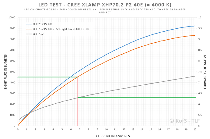

From koef3s LED test:
Looks like 6.8A and 6.3V, so approx. 43W. Since koef tested the 4000K model, and Wurkkos uses either 5000K or 6000K, my guess is it uses a 6A driver (37W). So, yeah, pretty much something betwen 35 and 40W, most likely.
Ofc, the flux bin of the LED affects this a lot, so does the CCT. Forward voltage fluctuates between individual LEDs as well.
I think I measured SP33 driver giving 5.7A on turbo. Been a long time since I measured it, so can’t be 100% sure.
They run probably 6 A at 6 volts for the driver output. Input at the battery is around 8-9 amps. The TS23 i tested did around that. The R9050 version will have lower output but similar power consumption
