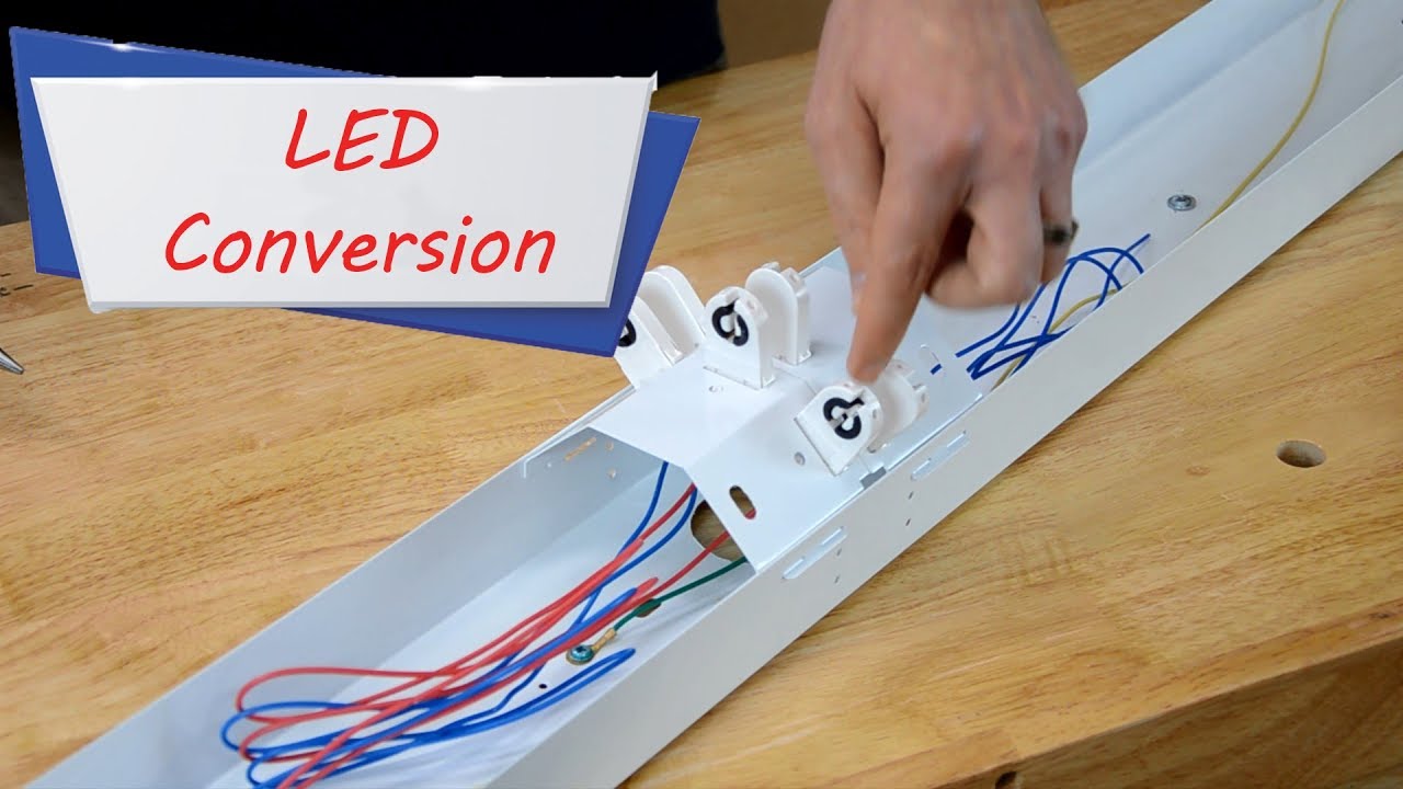

I removed the ballast. Now how do I connect the cables for led T8. Here is how the cables look like:

Are your tubes powered from both ends or one? The tubes should have come with a wiring diagram. If powered from both ends, incoming black goes to one end and white goes to the other. If powered from one end, the socket gets black to one side of the terminal and white to the other for both tubes. Twist and pull to remove the existing wire from the sockets. Google the brand for wiring diagram if you don’t have it. The tubes are in parallel.

It looks like reds and blues on the right go with black. And white with yellow on the left. Do I connect the the red and blue on the left to the white and yellow or ignore them?
All you need to do is connect the incoming black to all the right side sockets and the incoming white to all the left side sockets. Since this is a two ended system, it doesn’t matter if the sockets are shunted. This results in a parallel circuit. Use the right diagram as an example.
I don’t see any red and blue on the left side of the bulbs in the diagram. The ballast is gone at that point.
In the Hyperikon one there is no red and blue on the left side. But in my fixture there is. Here are the pictures: https://photos.app.goo.gl/JzLEQYRG3Co4stSC6
So, I guess I could consider the red and blue on the left as yellow?
Yeah, you could wrap the ends with white tape to alert future electricians or put some blue painters tape on the end with ( - ) written on it. You only need one wire per socket and it looks like you have an extra on both sides. I would remove the extra wire from both sides. The sockets easily pop out to access them better. Also, write with marker somewhere that the fixture is LED only so no one makes the mistake of putting a fluorescent in it at a later date.
