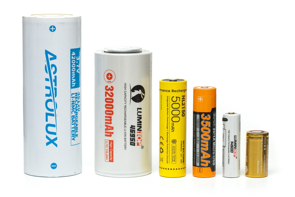

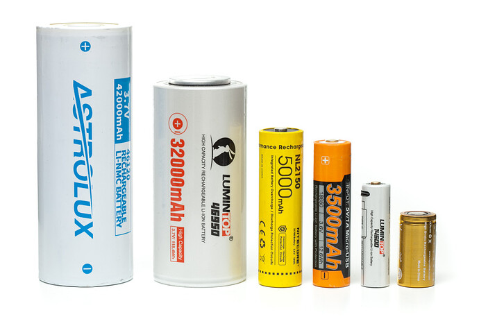

Here’s a picture of the 46120 next to other batteries:
46120 - 46950 - 21700 - 18650 - 14500 - 18350

I was hoping for a picture on the heads profile. To see if it charges from one end or both. Your link doesn’t work oh this end.

@texas_shooter : it has a single positive terminal on the front, and a negative terminal at the back… like most batteries. On the other hand, my Lumintop 46950 has both; positive, and negative in the front (like Olight batteries).

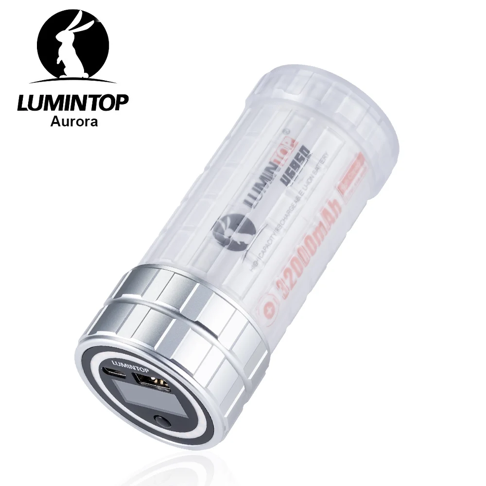

I recently decided to order a Lumintop Aurora powerbank (with a 46950 battery included), when it was on sale for €44,- and with a coupon it went down to € 39,-. An acceptable price for this combination.
This way I at least have a charger that is capable of charging my 46950 in a ‘reasonable time’ (20 or 22,5 wat I believe.)
I believe Lumintop has discontinued it, but it is still available in some places:

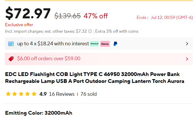

I should have picked up one of these a few months ago when I first saw them. They were close to the price you mention. The listing you linked now shows them at ~$77
At the time I posted that link, it was listed for something like 54 to 55 euro, which according to Google would be around $ 64,- with the current exchange rate. Currently the same listing shows € 49,99 for me. (And with all the coupon codes floating around, you can get a bit more off.)
So quite a high price you would have to pay. I suppose (partially) tariff related?
I would instantly buy another Aurora if I could buy it without the included battery (and therefore cheaper). I currently have 8 46950 batteries altogether (1 Lumintop and 7 Liitokala) and I just have no need for another battery! ![]()
Aliexpress does strange things with pricing depending on ones location, taxes, and I think other obscure criteria.
