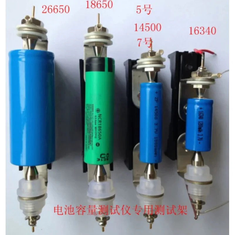

I found a few intresting holders… Now I have to dive a bit deeper, but this is likely what I’m after + RC charger & cables.
This is made by Gamry
I found this, which is available on Amazon
And some on Alibaba
and this one
This one on Amazon.in
I think now we’re coming close with this one: This says it’s a 4680 battery tester
And Aiexpress; YR1030, YR1035 zubehör 18650, 26650, 32650 zylindrische batterie test stehen - AliExpress 1420
And this: 5a (max 10a) 4-Draht-Prüfstand Batterie halter clip für 26650/18650 aa/aaa/Knopf batterie (Batterie nicht im Lieferumfang enthalten) - AliExpress 1420
And this one on Aliexpress… supposedly 15-20cm :smiley:
These look promising.

I have some of the 3rd holders from Vapcell.

Nice… I contacted Vapcell to see if they can sell these ‘adapters’ through Aliexpress… Dennis replied they can sell them, but waiting on how to go forward.
They have them on Alibaba, but not on Aliexpress (yet).
I got lost… What adapters are you thinking of?
Be careful with cell length. I have quite a few different holders for measuring IR. Not all of them will fit even 21700 cells.
sorry, I just wanted to reply to the thread :smiley: and not directly as a response to your post. Vapcell sells one of these adapters on Alibaba, so I reached out to Dennis to see if he can sell it on Aliexpress.
Vapcell also have a direct webshop, no? Id be interested to see these holders, I couldn’t find the Alibaba link
Good question. I didn’t know they had their own e-store. I used Google Image search to find these adapters.
I just visited their online store, but couldn’t find these adapters.
