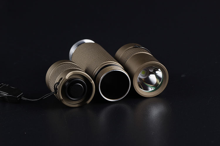

3) For most regular needs, this 1000 lumens turbo and 600-700 lumens constant light after stepdown is definetely enough. Yes, these numbers are not impressive nowadays, but believe me, they are really enough.
I`ve been reviewing like 30-40 flashlights in last 5 years, so i can pick any of them as my personal pocket light. And you know, i`ve been ok with 300lumens 14500 flashlight for some years, and feel ok now with 1000lums model.
This is enough to illuminate all the thing around during evening walks and it fits any pocket. If you want pay lowest price and get flashlight that you may rely on - Sofirn SP32 V2.0 is a pick for every beginner. It will give you enough light to work withing range of like 50meters.

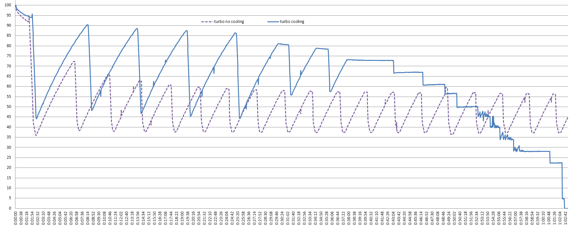

Thermoregulation - brightness control depending on the heating level of the flashlight. Mostly it relates to turbo as high normally shouldnt heat flashlight to the point when trigger of thermal regulation activates.
“sawtooth” is a clear example of poor , over aggressive thermoregulation. The flashlight heats up, the brightness drops. After some time at this level, as flashlight cools - the brightness jumps up again. The result is a moronic leapfrog.
For example, having bought a Klarus flashlight, with a high probability you will get just such a saw. Here is an example of a graph with and without cooling. In addition, there is a hellish gap between turbo and high. Seems like Klarus have saboteur at R&D, who does best to ruin good name of company - they`ve been repeating these mistakes almost in each model for years.
Good thermoregulation: with cooling (wind or forced fan cooling), the brightness either goes to a fully stabilized (ideally) level higher than high (the top picture is old and sold out Lumintop ODL20C) or increases continuously (turbo) (bottom picture). The latter I find more practical. Sustaining near-turbo level will delight you with good brightness and throw but will inevitably make runtime shorter for obvious reasons.
1) in most cases, there is no thermoregulation in cheap flashlights. So there are chances that it simply cannot be held in your hands (if you manage to find something brightner than 2000-3000 lumens). 2000 lumens in the size of a convoy C8 heat it to the point harmfull both to hands and batteries. Or to fhashlight itself in worst case.
2) Logically, flashlight heats up faster indor quicker than in the open air. And if there is winter and wind, then the difference can be enormous.
Convoy L6, although is not an example of cheap crafts, has no thermoregulation. With 2x26650 inside, it is able to hold maximum brightness for a quite long time, but you will have to look at the flashlight from the side. At 1st runtime chart may impress, but in reality you will be able to use it only in thick gloves and in really cold weather.

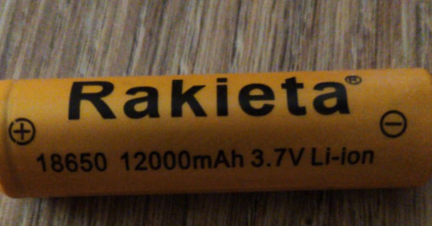

The last thing to say is* batteries and charging*. and here you need to know one thing.
Now, in 2019, the most capacious 18650 battery is 3500mah. no 7000-12000 and close does not exist. As a rule, in order to find out the actual capacity of such a battery, you need to take the zero at the end. 21700 batteries path their way toward and i belive that in closest future most of flashlights will support them as they can give you 5000mah in almost the same size.
If you need a capacious battery for a flashlight from aliexpress of amazon of from whatever, then in 9 cases out of 10 this repackaging of Panasonic NCR18650B
will work as well as expensive high-drain ones. real capacity will be around 3200-3300, there is a protection board. I order a lot of them and you will get no better for its price. ideal for flashlights below 2000lumens.

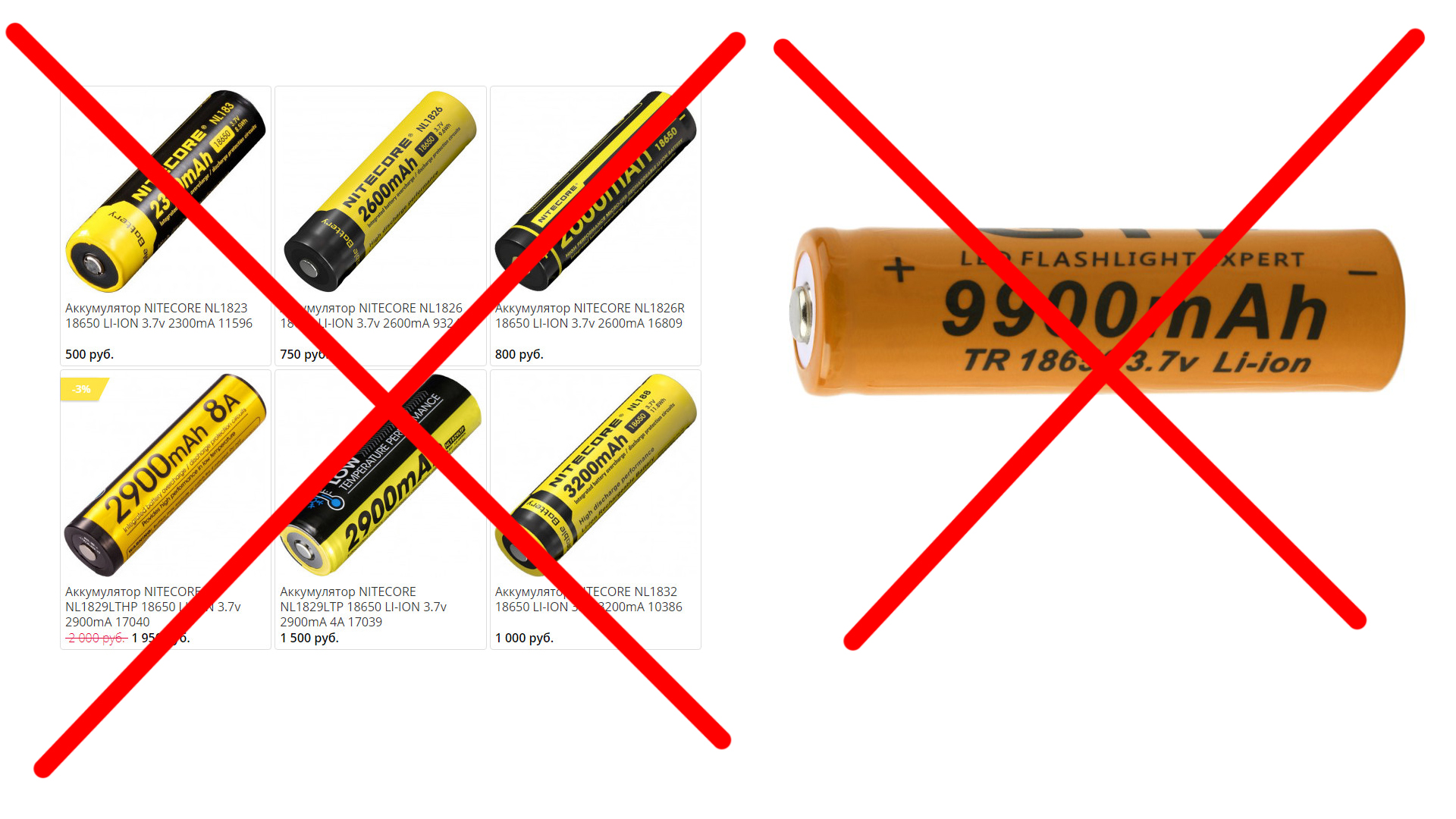

If the flashlight consumes more then 5A, then you should take care of buying some high-drain batteries. buying some top ones like ali or hg2 you likely get something worse packed insde heat-shring. But still in most of cases it will be ok for you. .
What is important to know. there are Samsung, Sony, Sanyo-Panasonic, LG. that is all of big brands. there are no such battery manufacturers as ultrafire, trustfire and other things (especially with *fire at the end of the name). What kind of chemistry is inside is unclear. Clear is that buying this you get from 1\3 to 1\10 of stated.
Equally, there is no point in buying expensive Nitecore \ Fenix ​​\ Olight etc batteries. You will pay a 2-3 time more than battery really cost just for having brand heatshrink.
