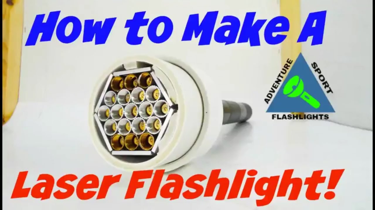

Hi everyone,
This was something I decided to experiment with. I had not ever made anything with lasers before so I figured it was time to give it a shot.
Please let me know what you think. Was this an entertaining vid for you? Would you like to see more projects like this? Would you rather have the 4 minutes of your life back? LOL!

Looks pretty cool, always interesting to see what other members get up too.
Just curious though and not meaning to put a dampener on it, but how safe is it, I mean for the eyes, especially in the shots where your shining it around inside, is not the reflected laser light bad for the eyes ?
I’ve always fancied experimenting with lasers but some of the stories of the dangers rather put me off as I value my sight, so have always aired on the side of caution, or is it really fairly safe ?
It is a good idea to have some safety glasses around. These are pretty low power, but I got a pair anyway. Just make sure you get the ones that are rated for your lasers wavelength ( IE 532nn) and NOT just the color of laser.
Here are the ones I got.

Careful, careful, careful!!
I can’t find any rating on the above goggles (OD, optical density), and even if one were listed, I wouldn’t trust my eyeballs to a pair of <10bux goggles.
Take the laser, shine it on the wall from a few feet away. Now put the goggles in front of the laser. If you see, well, anything, on the wall, they’re not good. At best they’d slightly limit damage to your eyeballs, but at worse, they’re a false sense of security and you can do some serious damage before you even know it.
Even a paltry OD3 (meh) would reduce the laser’s intensity by 1000, and an OD5 (decent) would reduce it to 1/100,000th its intensity. So if you can still see the laser shining on the wall, like, at all, they’re just tinted plastic.
I play around with 1W violet lasers and occasionally some more powerful ones. Even a glancing reflection from a screw-head across the room for the smallest fraction of a second could burn your retina and leave you with a permanent blind-spot (or -streak) for the rest of your life.
