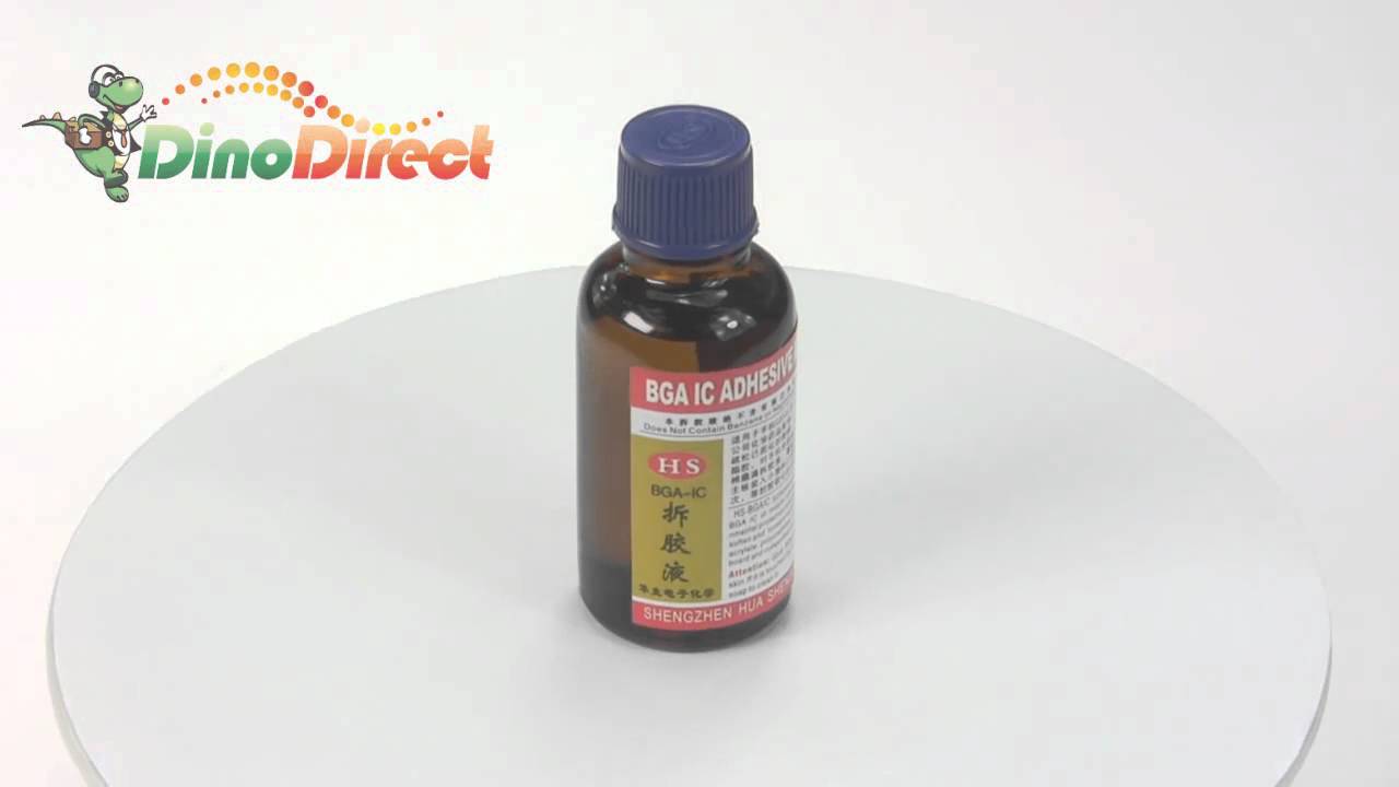

After recovering from another bout of food poisoning I managed to translate the contents of the anit-ahesive vial, and it doesn’t state what it’s made of, just how to use it and what it does. Typical. It’s nothing special though, I’d suspect you’d be able to buy the same or a similar product at your local hardware store.
Does it have a distinctive smell?
Hope you’re all right, wkJR. Thanks for the info though.
Thanks for the feedback, WKJR. Will check out the stores. Hope you get well soon. When i get tummy flu and nothing seems to keep itself in, I just do a liquid diet of non-carbonated isotonic drinks like Gatorade for a day or 2.
It smells very similar to shoe polish, with a gooey yet watery texture.
Thanks ryansoh3, Orion, it’s really no big deal, probably the 3rd time in 3 years it’s happened, would help if I tried to get more rice and vegetables in my diet instead of being such a carnivore, meat’s something to be careful with around these parts.
Think I just figured it out, the one thing that wouldn’t translate was “IC”, and after some research:
A number of vendors sell it at Ali-express:
Here’s what I’m using:
It’s most likely the same stuff.

Tks Justin. Now I know who to send my remaining locked flashlight heads to! LOL. Already tried boiling, and some heads came off, but some didn’t. Either gonna get me a heat gun or strap clamps maybe. Dun wanna ruin the finishing. Btw just found out what BGA IC means : ball grid array and integrated circuits -

That makes sense… China flashlight factories could be using adhesives that aren’t listed. So perhaps their shenzen-made IGA IC adhesive remover applies to them as a solvent better.
Anyone able to update this?
The BGA stuff is still available from several sources, here’s one:
http://alexnld.com/product/30ml-ic-bga-chip-epoxy-glue-remover-adhesive-solution-solvent-liquid/
Checking before buying some (and I do rather wonder what the stuff is).

… dangerous if you don’t take precautions. The basics apply - don’t let it get on your skin, ensure ample ventilation (FUN FACT- at room temperature, one decomposition product of Attack is phosgene… a military chemical weapons grade choking agent!!!) to prevent catching a whiff, and store in a proper container. I use all glass or HDPE containers - the vapors alone will dissolve other plastics.
https://www.riogrande.com/Content/Attack-Adhesive-Remover-MSDS-pdf
Dichloromethane and Dimethylforamide
