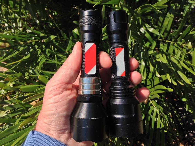

I prefer to cover mine with a cut-to-fit piece of reflective tape .
No when it is laser cut it would not be higher, laying ON the surface.
Tape, hmm that is ehm, not so nice to look at IMHO, sorry.
I read acetone could do it, will buy Monday and test it on an Ultrafire.
Yeah , it’s more about function over form for me .
Plus , I’m a barber , so having a barber pole on my lights seems kind of appropriate .
