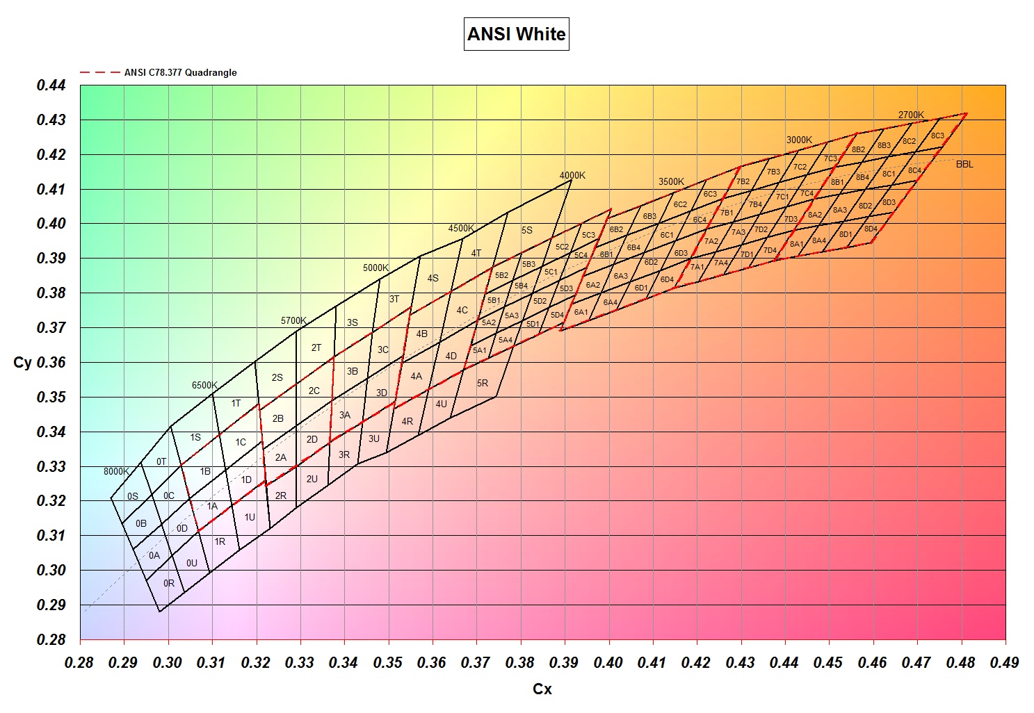

Would this be the chart that relates to those bin numbers? I do see the 1D and 2A on there but not the other ones. At this point im just following through out of curiosity and the desire to learn, not so much the desire to chase my version of perfection…
It seems like those numbers for convoy are listing the bins for each of the CCT’s rather than having multiple bins to choosee from?
1D and 2A are ANSI white bins, 50G etc are easy white bins. In short ANSI white guarantees roseiness, easy white is tint lottery, since the bin represents a ellipse around the BBL. Can be above, can be below, or anything in between.
