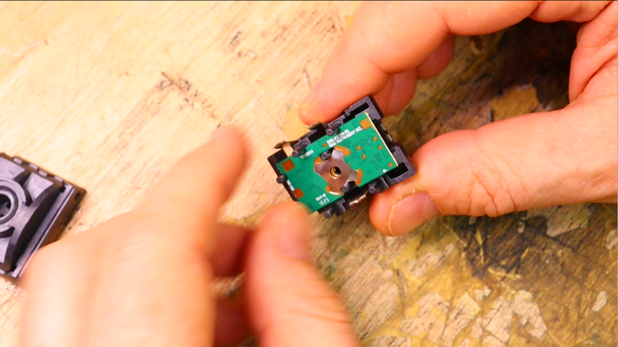

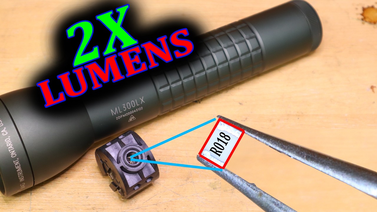

To do this I took the driver out of the Maglite switch.

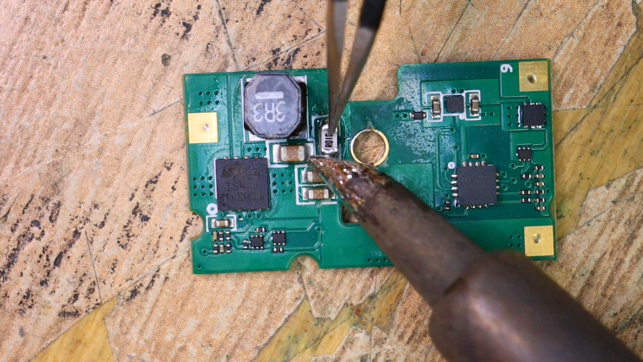

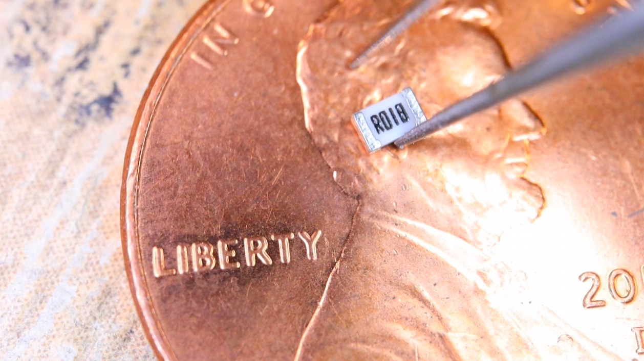

Then I added this tiny sense resistor over the top of the factory sense resistor (do not remove any parts from the driver)

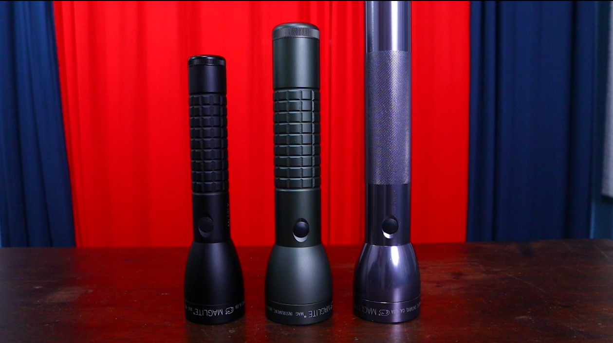

I tested this on several maglites and it works with all the ones I tried (ML50L 2C, ML300L 2D, ML300L 2D

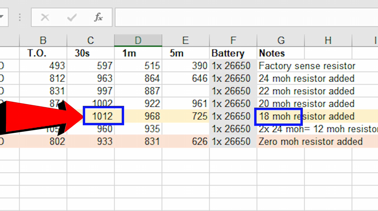

I tested a wide range of resistors to see what worked the best. For the 2C a 14moh 1/2w 0805, and for the 2D and 3D an18 moh 1/2w 0805.
I have extra of the resistors if you guys want any: https://shorturl.at/VHJyE
I tested clear down to a zero ohm, but performance is actually better in most cases if you leave some resistance in the circuit. For example the 2D had a bout 100 less lumens at peak with the zero ohm.
