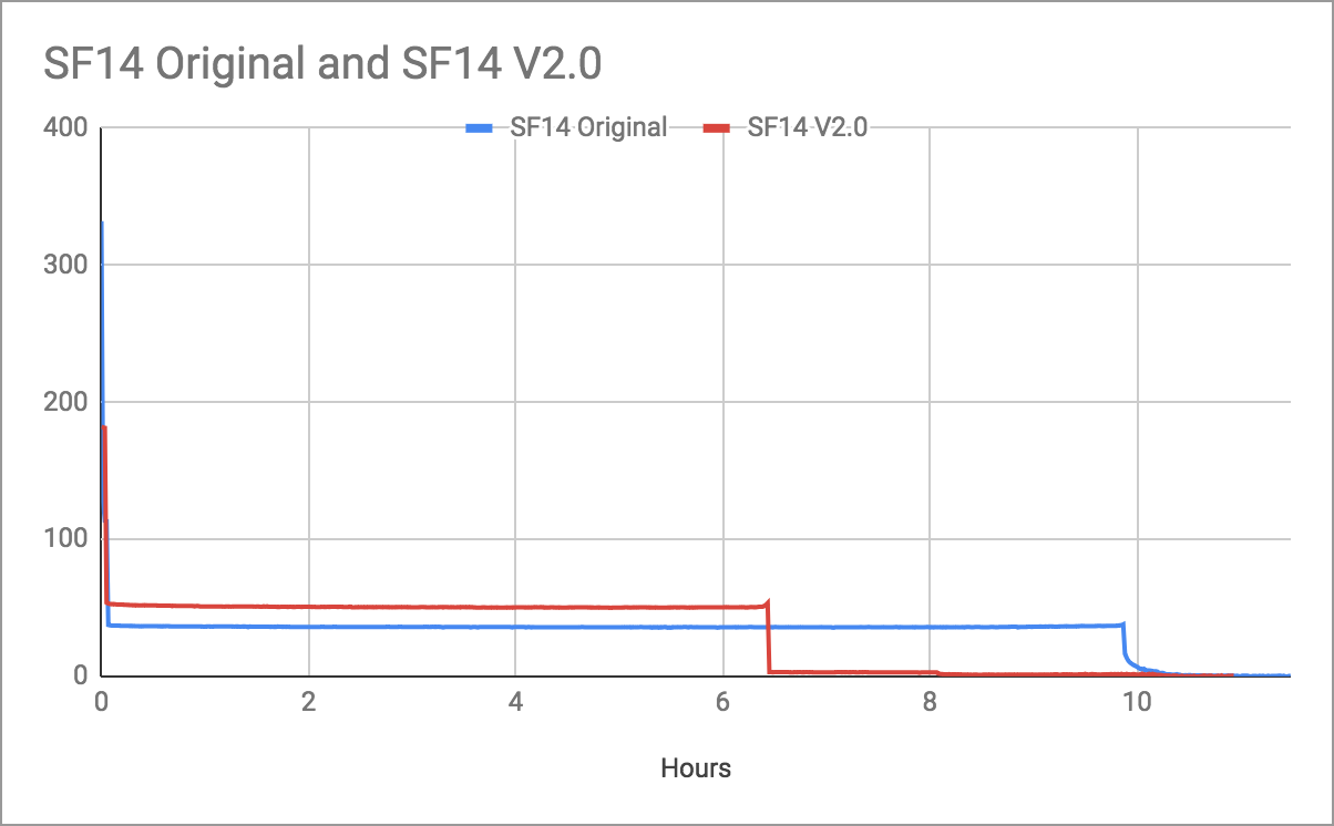

Here's a chart where you can expect the light to come on bright and immediately dim to something usable:
Let's pick on Sofirn a bit, because they earn every "lackluster-lumen" mention they get:
PT16 110 gm
about 550 lumens for about 60 minutes
5 lumens per gram
This seems normal
SF14 63 gm
about 50 lumens, for about 7 hours (similar to 350 lumens for 1 hour or 5.6 lumens per gram)
> Let’s pick on Sofirn a bit, because they earn every “lackluster-lumen” mention they get:
I see the output is quite low… otoh, the Runtime is Quite Long… just trade offs…. more hours, less lumens = less hours, more lumens
it all fits a pattern… the Sustainable Output is directly related to the carry weight including battery, of the host.
so far, 5 lumens per gram for about an hour, seems to be a reasonable ballpark expectation for Sustainable Output.
I don't have issue with the SF14 flashlight running for 7 hours at 50 lumens...
It seems the claim of it being a 600 lumen flashlight is technically "true" in that it can make 600 lumens for 1/2 second, though it's not a usable 600 lumens, more like a usable 50 lumens.
