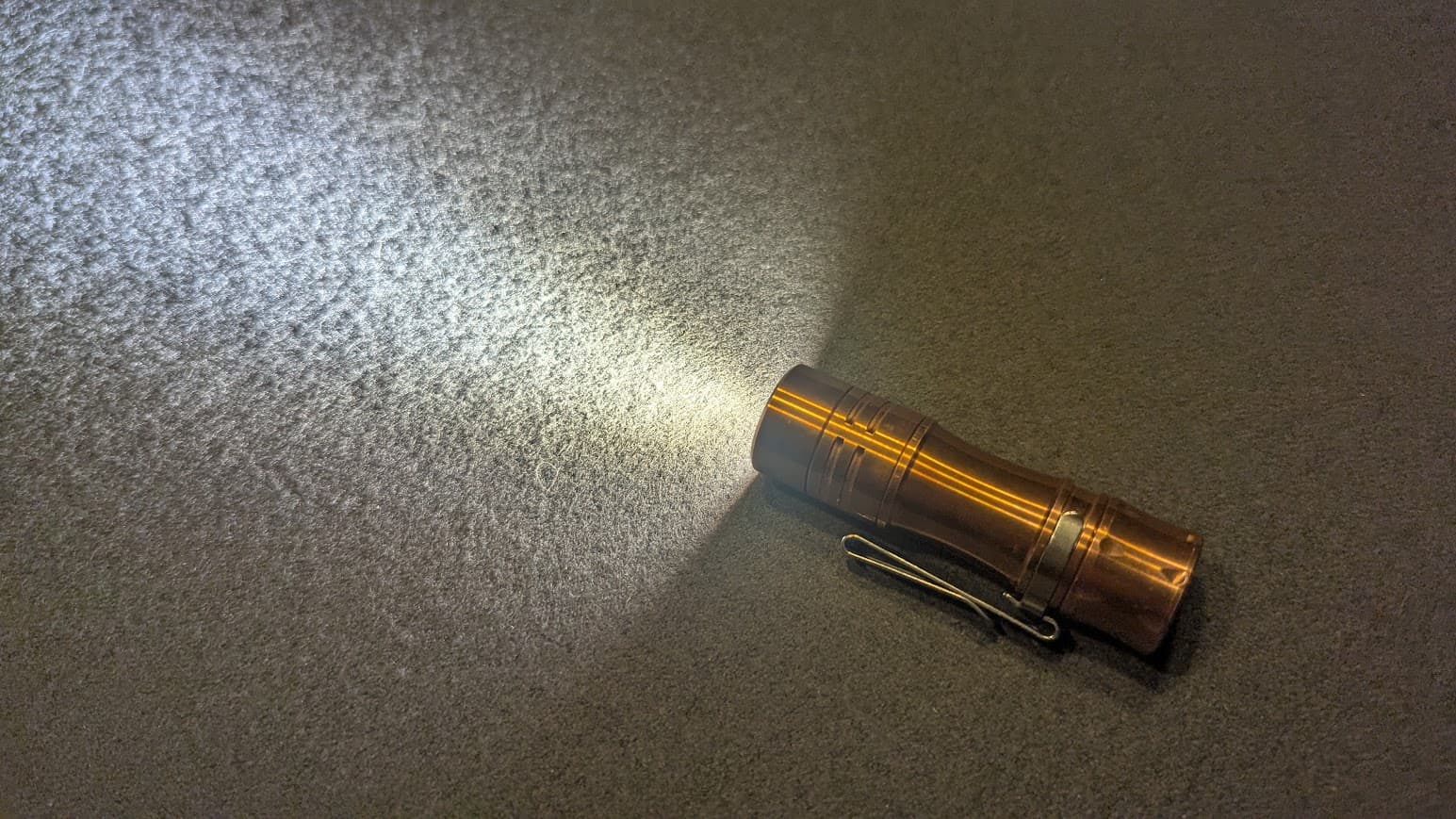

I also modded my copper TS10 with some E21A 4000k. They were supposed to be 2700k. But, I was sent the wrong ones. I really wanted a warm light with the copper. Either way, it’s still an improvement over the CSP’s.

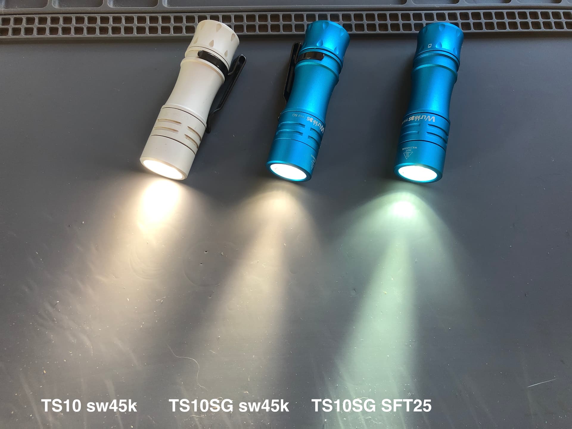

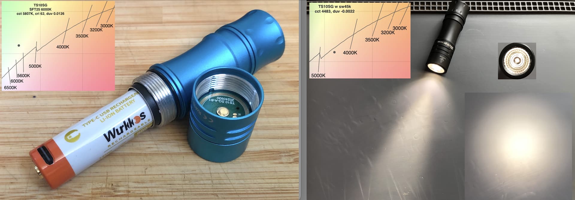

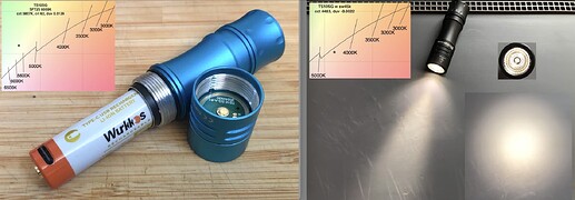

btw, Sammy shared some good beam photos in his review
beam comparisons, left to right least to most throw:
That green really comes out next to the SW45K
yes, I was hoping the SFT25 cool green tint would help show a little pink from the sw45k
I was surprised that at night, the SFT25 green tint is not noticeable.. it has given me a new appreciation of Cool White Low CRI for outdoor use.
