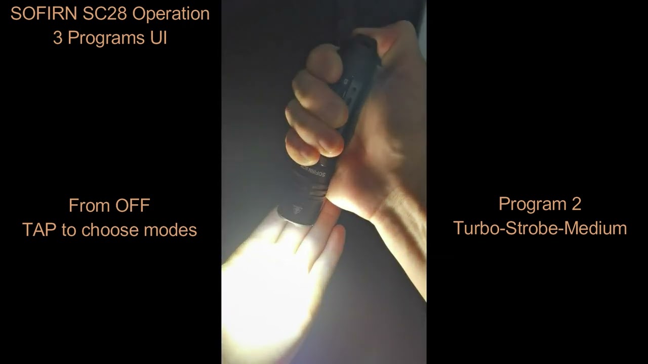

I made a video to show how to choose brightness levels and switch programs.
Hope it helps.

Hello, thanks for sharing your experience designing a commercial light.
I tried just watching the video, but I found the text from Amaz helpful to describe the current design.
To toggle through these 3 programs, wait 5 seconds from ON, when you see it flashes, do fast double-click to the next program. It flashes twice to remind the success. If you keep going double-click quickly, it keeps changing programs. After the program being selected, wait for about 3 seconds before changing brightness levels.
I feel like I could potentially switch programs after reading that and watching the video. I might restate it as
“ To toggle through these 3 programs, turn on and continue holding the switch for 5 seconds. When the light flashes, then quickly double-click to advance to the next program. Additional double-clicks will continue advancing. When finished, the light flashes twice to indicate success. After the program being selected, wait for about 3 seconds before changing brightness levels.”
A flow chart diagram would be a great enhancement as well.
Since you asked for feedback, how about Program 3: medium-only? The simplest flashlights are just on/off. That said, picking just three modes to ship sounds like quite a challenge and I think the design seems pretty reasonable!
