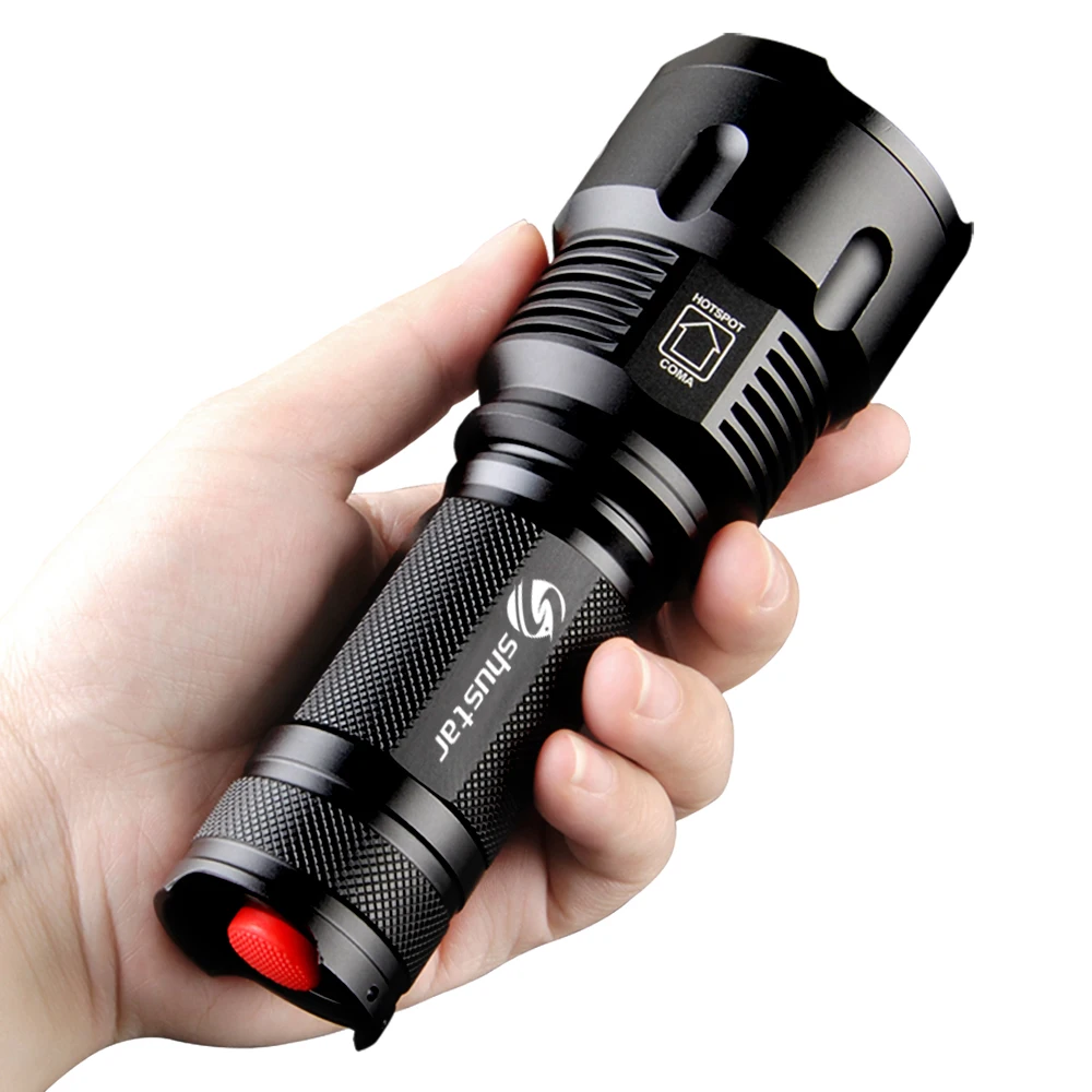

Another MT-G2 will go into a Zoomie. Link: https://www.aliexpress.com/item/Powerful-Tactical-LED-Flashlight-T6-Led-lamp-10000-Lumens-Zoomable-Waterproof-Torch-for-26650-Rechargeable-or/32844920042.html?spm=a2g0s.13010208.99999999.260.131a3c00yzi71H

Thoughts on a MT-G2 in the Zoomie I pictured? Or would another LED be better?

Does that look like some sort of Warsun? 28mm head travel path…
I wonder how good is the emitter shelf/cooling inside of that aluminium can.
I may try Kaidomain's “fishing flashlight host” some day, huge space for driver (∅23mm) and led board (∅26mm). :THUMBS-UP:
Cheers :-)
All easy fixes. It will make an ideal zoomie.
