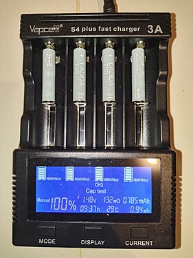

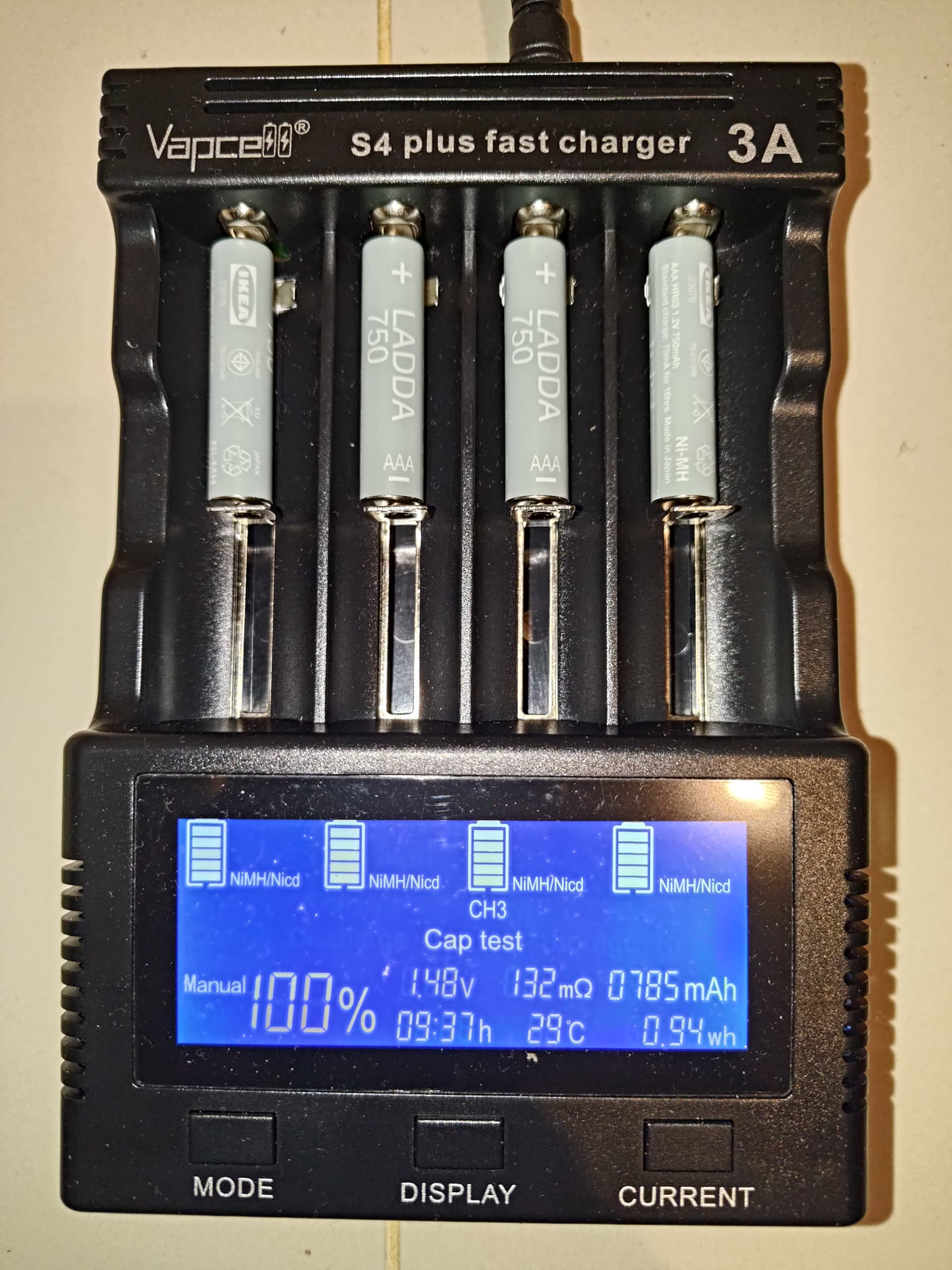

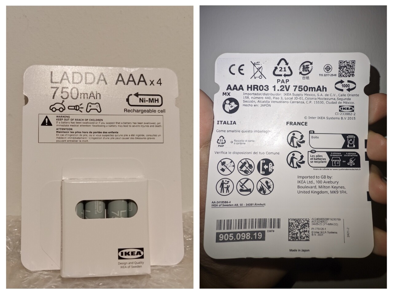

I recently bought a pack of Ladda AAA. It seem the labels at the back was changed (but still made in Japan). The production date is 2024 week 21 so around May 2024.
I made a test with S4+ V3 charger
The result were
  • 835 mAh
  • 783 mAh
  • 785 mAh
  • 807 mAh
I use these cell for keychain light and will eventually replace a few clocks and remotes (that came with alkaleak)
