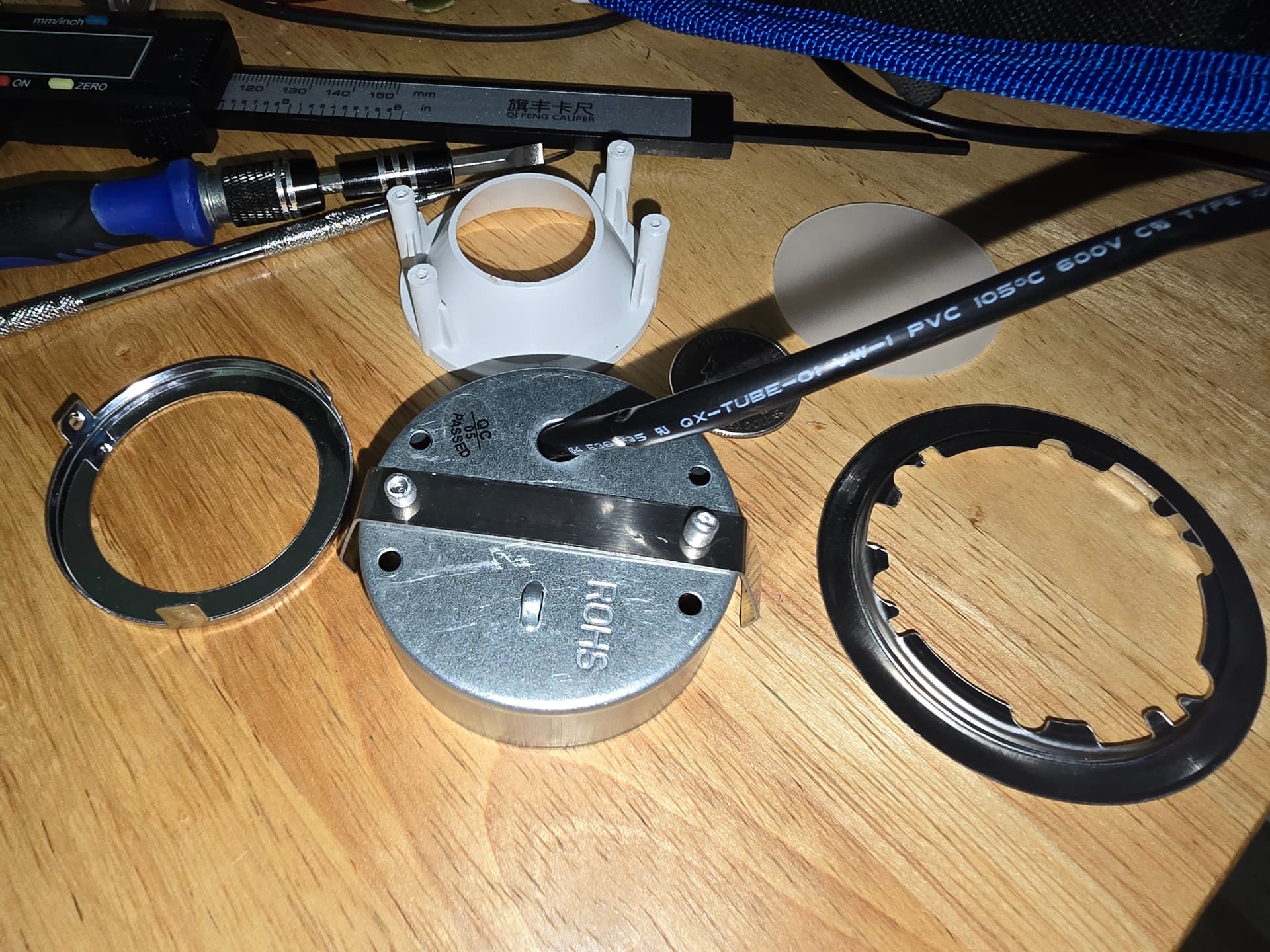

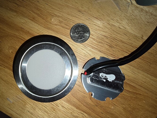

The four LED modules are listed as 12v 3w in the manual. Inside they contain a 1mm thick by 48mm round aluminum board with 8x 5730 LEDs. It’s labeled with part number SR-5730-4S2P. On the back side is a 20x40x3mm solid aluminum heatsink and some thermal compound.
One thing to note, the arrangement of the 8 of the leds are grouped in the very center of the 48mm board to fit inside the 26mm cone opening of the housing, so many of the 6w and 9w boards I found won’t work due to the LEDs being placed all over the board.
