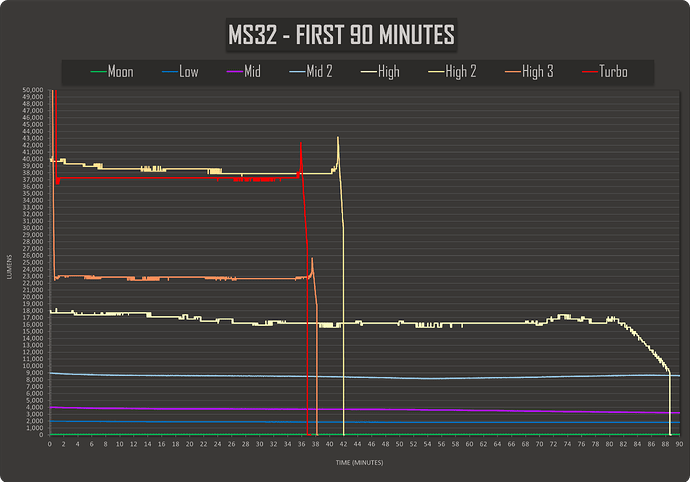

MS32 - First 90 Minutes
All of the high modes drop out within 90 minutes. Turbo sustains 37K for 36 minutes, while High 2 holds over 38K before dying at 42 minutes. Note the sudden increase in output on the highest modes, the pattern we expect with a linear driver. Regulation is quite good on all these highest modes.
