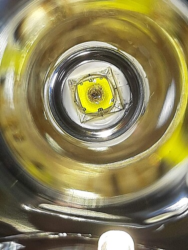

UPDATE: Imalent fully refunded me and are sending a new head for free. They wanted to thank me for the effort that went into my review, so that’s very kind of them tbh. A very unexpected outcome.
Well, hopefully the new head has been tweaked so it doesn’t just burn up again ![]()
They said “we will send you a new upgraded SR32 head for free” so I’m presuming it should be fine. The High level steps down immediately, so hopefully this is one of the fixes. I’ll test it and provide an update on my channel and here also.
Well that’s a relief, it’s good to hear that they aren’t leaving you with a ~$600 loss. I hope they are helping non-Youtubers in the same way. Their initial reaction made it seem like an average buyer might have issues.
I received it with a reviewer’s discount, but certainly not free
other people are reporting that Imalent are covering the return shipping and shipping a new head. Imalent said the issues have been resolved, but then I hear from multiple people saying their SR32 or replacement head is being held until they figure out the cause. I have no clue at this point whether Imalent know exactly why it’s happening. Unless Imalent know the cause and are having to open and inspect every unit. They said it was just flux splashes from soldering, so maybe they’re opening and cleaning all LEDs.
Sounds like they’re looking after their customers at least. I can no longer say anything negative about them, I think it could have been also down to poor communication from my contact when I thought I had to cover the return shipping. Returning just the head was $107-$200 nzd, so I was fairly upset at that point. They still want the faulty head back, but now that I have my money back I’ll send it as economy for $50, instead of courier standard for $107 or Express for $200. NZ Post for exporting is expensive.
One thing that is risky, is that they ask for a customs declared value of $15 usd so they don’t have to pay tax. This was very concerning for me because if lost, I’m only compensated for $15. Then the question in my mind was, are they going to still send a new head if the package doesn’t arrive?. As a large company they should be paying that tax and allowing the customer to value it at what X part would cost to replace.
A little update from Germany:
The TLF has a tradition of doing pass-arounds where a manufacturer or dealer provides a flashlight that is passed around between usually 10 participant, each for 1-2 days. Two weeks ago the first Imalent SR32 died with a burned LED, already at the second participant! It hasn’t seen much turbo at all.
It got replaced by Imalent via a well known dealer from Germany. The pass-around continued. Two participants later it died again, this time with two burned LEDs.
Imalent refunded me and replaced the SR32. I think they sent me a replacement head because they ideally want a positive review from me.
The new head has been perfectly fine with multiple turbo runs without any burning LEDs. There are a couple of black specks on some of the LEDs, but it arrived like this and haven’t developed into burns. Imalent said that it’s QC issues from CREE. If it’s poor QC from CREE, then maybe, just maybe Imalent should improve their own QC and not install the LEDs with these black marks.
Imalent shipped me an SR16 for a comparison video and I see the same black specks on one LED on the SR16 too.
The SR32 and SR16 had a layer of glue over the handle contact, this caused the handle switch to malfunction. I scratched off the layer of glue and both units have been working flawlessly. Imalent just need to improve their QC.
Imalent informed me that only 4 units including mine had the burning issue, but this is simply not true.
Imalent lies.
