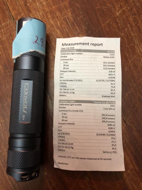

I always measure my maukka calibrated lights first.

This is my reference calibrated light from maukka.
