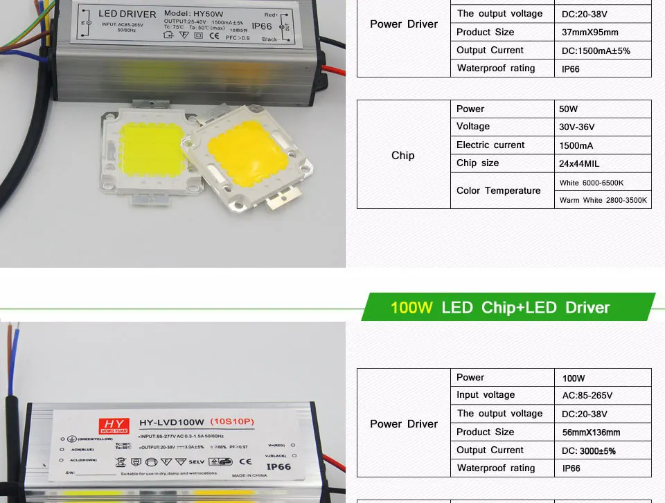

Those cheap 100W COB leds costs only a few dollars and can deliver around 8000 lumens
The main thing is a true 33V 3A driver costs about 20$ so they put a 33V 600mA in there that costs only a few dollars to make the light work and sell cheap to people dont know its a fake driver
A proper passive heatsink for 100W will cost also like >10$ or an active with fan 5$

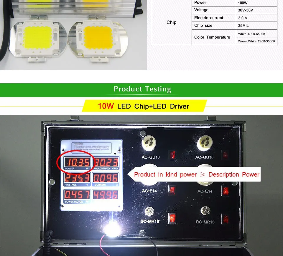

Here you got an example of a quality 100W Epistar COB with real 3A driver for 32$
Just look how big a true 50 and 100W power supply is
LOL
The 50W drivers I found are barely bigger than the chips themselves… :person_facepalming:
I purchased a DC/DC boost converter rated 30V/150W and which can be powered by 12V source, I hope it can delivery at least 100W (but I paid 7$ for it… )
I think relying on a 12V source is easier for designing than on these unusual 30V power sources, which I can’t even find in real shops here in Italy (max 24V).
