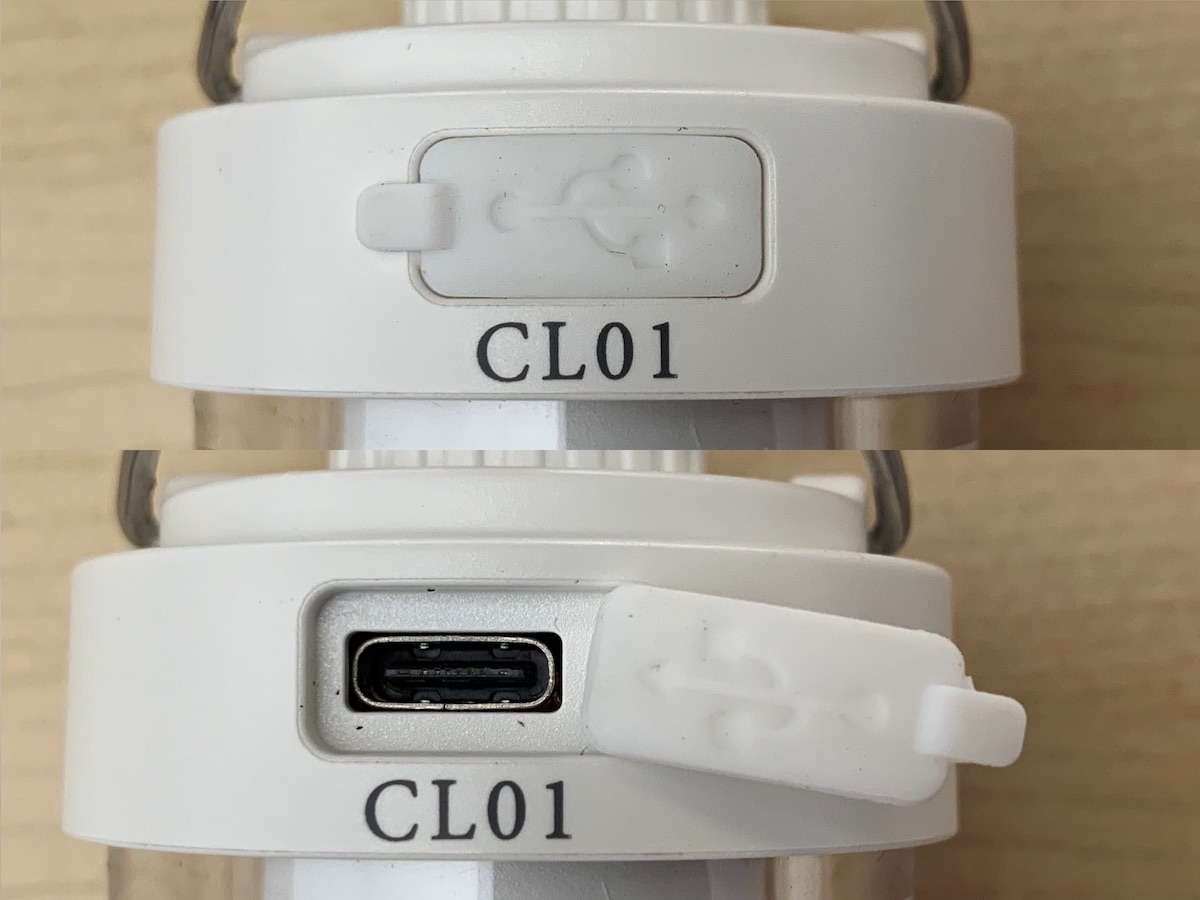

To recharge the cell, as well as provide power bank output, there is a USB Type-C port on the side of the head, protected by a color-matched silicone cover.
Its opening measures approximately 11.8 x 6.8mm, so cables with larger overmolds (connector housings) will present a problem, and not fit into the confines of the receptacle space. The overmolds on the bundled cable measure ~10 x 5.9mm, and there is little margin to spare.
As such, I can only reserve comment on the characteristics of the port, as my normal cables are incompatible.

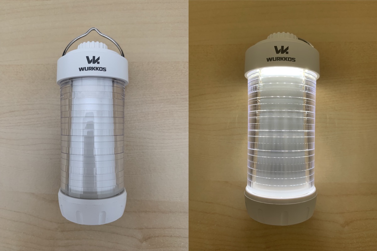

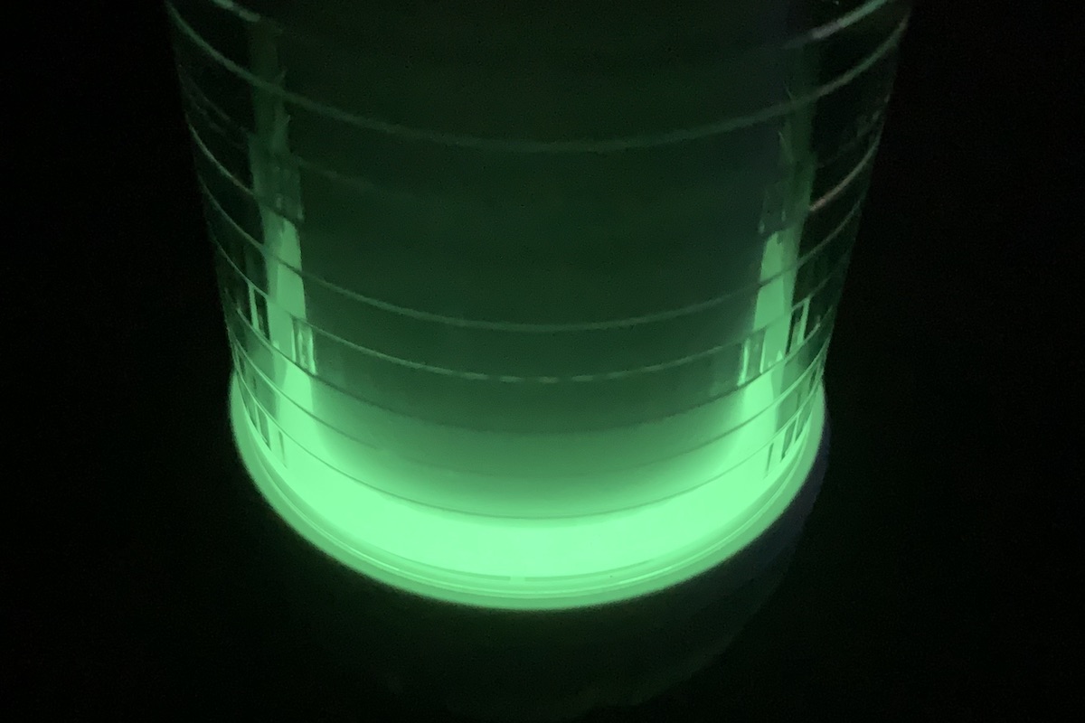

The approach that the CL01 takes lies somewhere between the two extremes, with a ring of downward facing emitters at the top of the lantern, a clear cylindrical lens body with prismatic rings to capture and disperse their output, and somewhat uniquely, a GITD ring at the bottom to further help distribute the light.
The bottom ring not only glows in the dark, but also disperses light in a bright enough fashion that suggests there are also emitters in the base, but that is not the case, nor is it mirrored to achieve that level of brightness. It’s an interesting component that works quite efficiently.
In appearance, the bulk of the lighting originates from the top, and bottom of the lantern, which are discernible as the primary emitting sources, but not in an overly harsh, or glaring manner. The prismatic optics and central core also play a role is light distribution, albeit minor, but without causing notable artifacts in the emission pattern.
Overall, the quality of light isn’t offensive, nor betray the cost of the optical approach as it does in many inexpensive lanterns.
