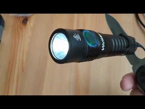

No brain transplant yet, but my review is up:
[image] Disclaimer: I was kindly offered the Wurkkos FC11 flashlight for review. Amazon link (non-aff) General Info: The Wurkkos FC11 is a compact 18650 flashlight. It is USB-C (woohoo!) rechargeable and comes with a 3000mAh Wurkkos-branded 18650 battery, among other things. The LED is a Samsung LH351D 90-CRI 5000K, one of my current favorite LEDs: good lumen output, no obvious tint-shift, my fav CCT, etc. Spec’ed output is 1300 lumens from it’s FET-based driver. It has a single side e-sw…

I just received mine.
- there is a bug in ui: if turbo or strobe is accessed directly from off, long press activates last used mode. From that state, flashlight cannot be turned off and mode cannot be changed. Only action is double/tripple click to go back to turbo/strobe and then flashlight can be turned off,
- there is a PWM detectable by phone camera (similar speed to bistro firmware),
- high (~1.7A tailcap current) step down is after 5 minutes to 60% of initial high mode, which is almost equal to medium mode,
- turbo (~3.9A tailcap current) step down is after 1 minute, lasts 30 seconds, so after 1:30 flashlight is on 20% of initial turbo mode, which is almost equal to medium mode,
- standby: 1.41 mA initially, 0.03 mA (= 43 μA measured on different scale on my DMM) after few seconds,
- eco: 7.67 mA
- glass is not AR coated,
- during charging flashlight can be turned on in low mode,
- with charging cable connected flashlight can be turned on in low mode even without battery,
- magnet is strong, flashlight can be attached to round pipe in horizontal position without an issue,
- magnet in the tail is probably not glued and small rattle can be heard when flashlight is detached from a surface,
- fins around head are rough,
- tailcap lanyard hole area is also rough,
- fc11 and convoy s2+ have the same size.
Overall pretty nice piece of lumens ![]()
