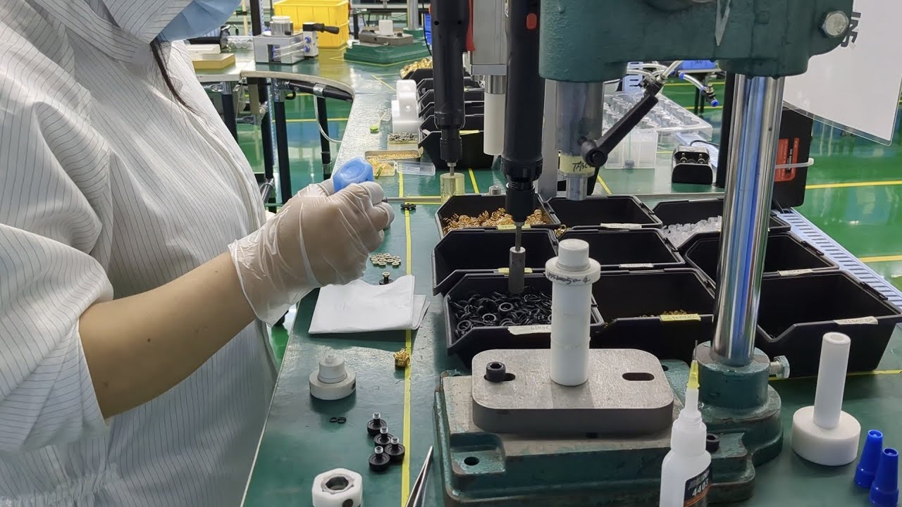

Here is a video from when I visited NEXTORCH on 9 April 2024:
Its hard to believe their factory is so clean and so well run.
It looks more like a factory that makes computer chips.
Do they really make the lights one at a time by hand?
I dont even think the Surefire factory looks like that.
I’d say that it’s a combination of automation, manual work, and being well organised.
They make the individual parts in the CNC and lathe area, send some parts away (e.g. reflectors to polish, or tubes to anodise), perform quality checks when they receive the parts back, and then supply those to the clean assembly areas.
The Surface Mount Technology room automatically fed PCBs into the pick and place machine, added components, moved them through a reflow oven and has an automated optical checks. Half a dozen people were doing manual electronic checks.
NEXTORCH setup their assembly lines for the TA20 and WL50 so that the tail and head are assembled at each end and the final flashlight is put together in the middle.
The TA30C had a similar assembly line but in the shape of a semicircle with one person. Custom machines helped improve the efficiency.
I was given the opportunity to assemble my own TA30C but it was pretty obvious that the workers are highly skilled. I only attempted inserting a reflector, lens and bezel.
